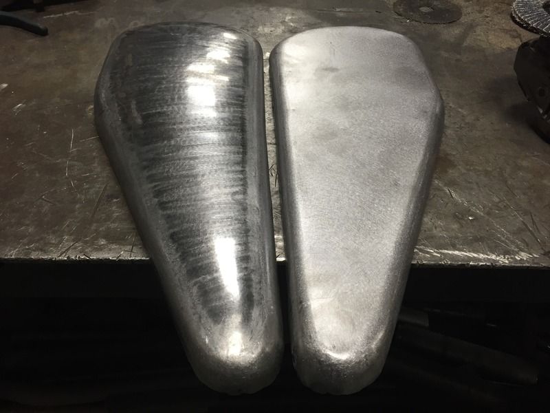

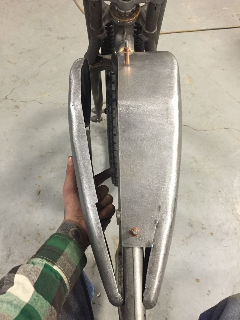

I had made some pretty good headway on the tanks, they were starting to look like something, but I haven't been very happy with them the whole time ive been building them. I tried using some shorter tank sides that I had made, then just lengthen them to how people voted they wanted them(I did a vote on instagram a while back) they just weren't turning out right(damn OCD), so I threw in the towel and started over, built a new buck and hammered out some new sides last night, I am very pleased how they turned out!
Photos:

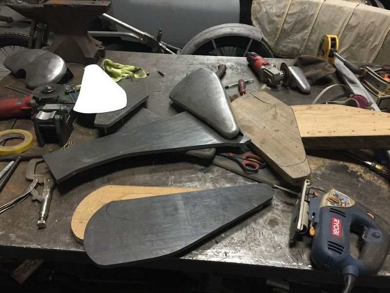

you can see here the length difference, I started to section it, that's when I threw in the towel with these sets
How I left it before heading to Mama Tried. It looked good, but it wasn't perfect!
You can get a sense of panic and frustration by the mess on my table while building the new buck lol

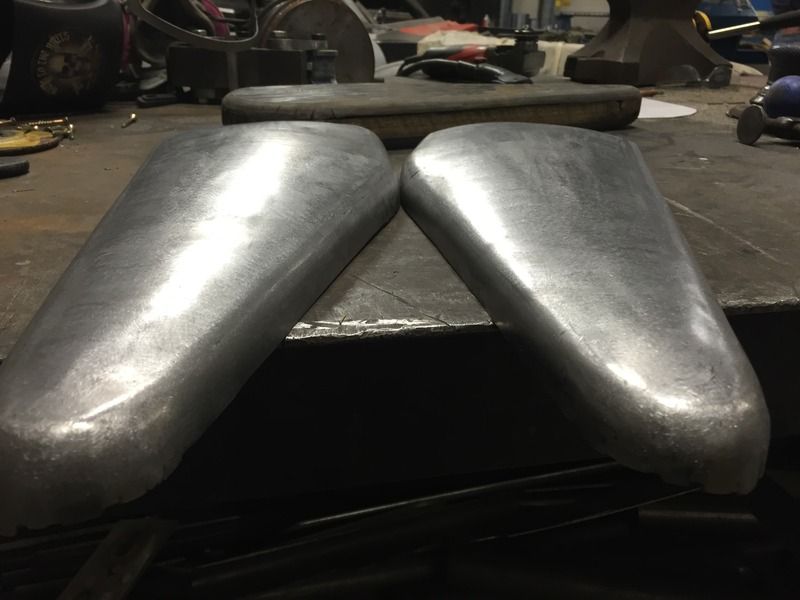

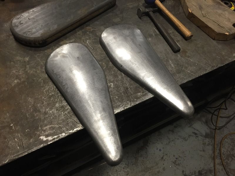

New tank sides, left side after first run roughing out the shape on the planishing hammer, right side right off the buck. You can see though, perfect match!
Both sides roughed in, they will get even more "shape" in the next round of working on them!
Here you can see the little bit of profile added, that's only about 5-10min a piece on the hammer, amazing how quickly they can start to look like something!

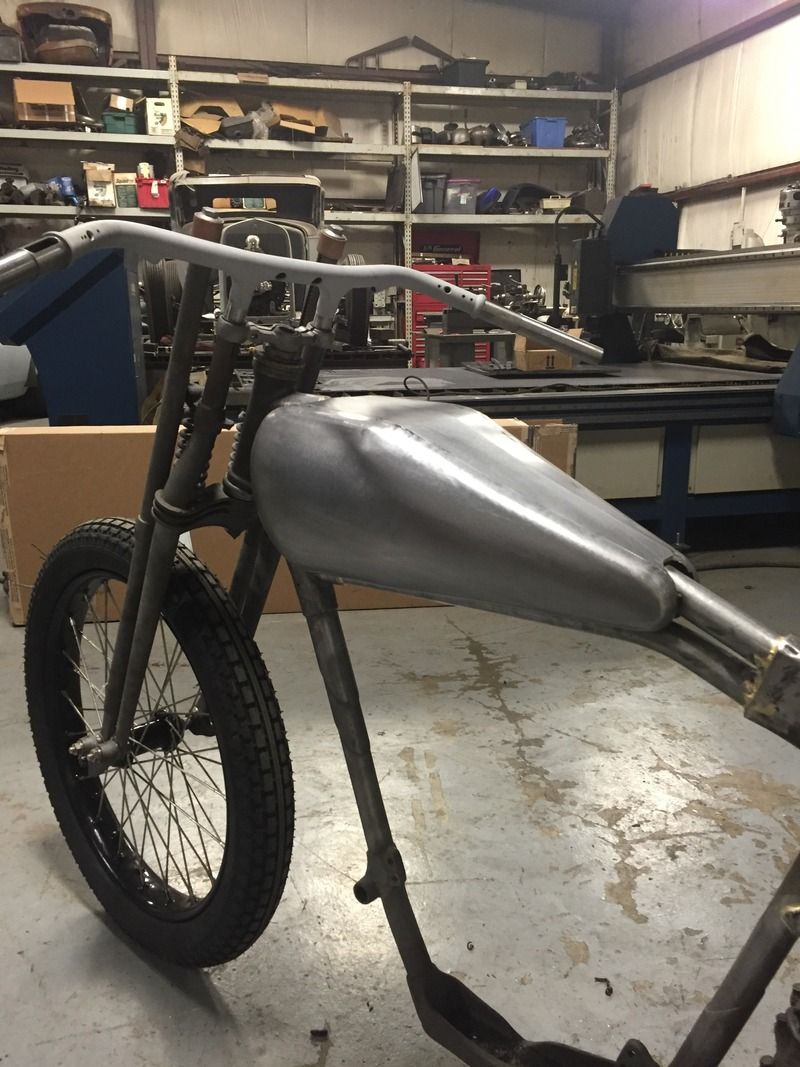

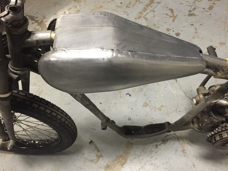

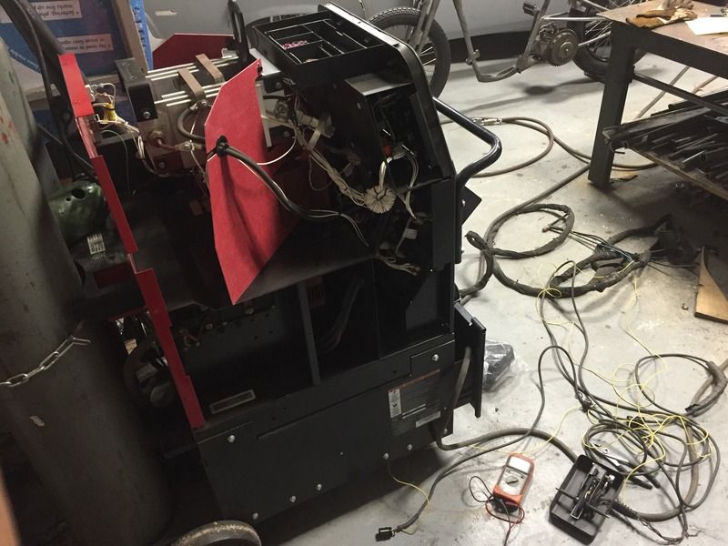

I planned on spending all of Monday evening on the bike, I sat aside from 5pm after customer projects until midnight for the bike, BUT.. I spent some time on the tank sides on the hammer, then need to weld up some bits and my damn welder wouldn't work, being that it sets my whole shop, and this project into a stand still, I needed to fix it! I spent most of the evening messing with it and trying to track it down, I finally threw in the towel with the thought that it was the amp control switch. Luckily Delille came through and had the part in stock, success, it worked again!
On to the tanks, I spent quite a few hours on it last night, hammering them out and getting some progress on them, finally starting to be able to see how they will look, very similar to the last set, I added quite a bit of radius to the sides and made the transitions a lot more smooth, since we went with the longer tanks that resemble the j tanks more, I figure I should make them completely resemble them.
Thanks for looking! I plan on putting some more hours in tonight, maybe ill work on the bars, or the frontend to give you guys something else besides tanks to look at lol.
