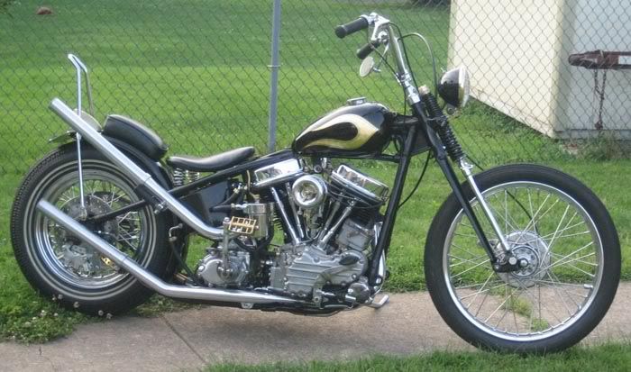

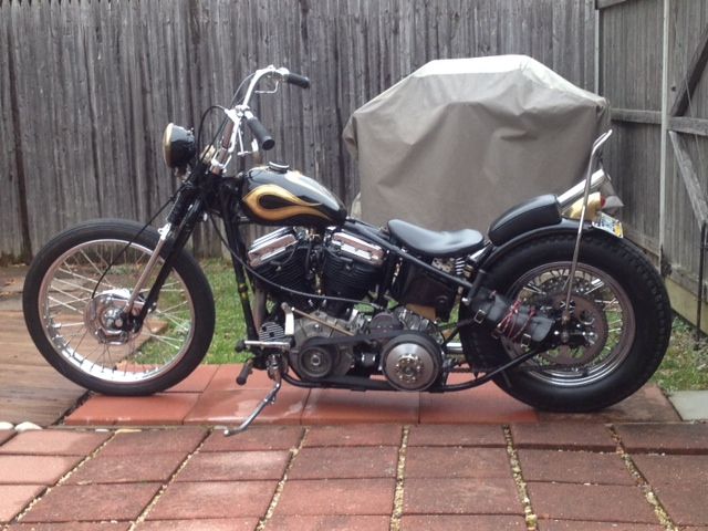

Guy...change nothing, man...that's tits. I guarantee it will stop better than any early Harley drum/brake setup you put on there.
And yes, Teddy's Taiwan repop springer brake drums/backing plate/brake shackle will work on VLs if the rockers are later era and you are using a star hub and correct axle/axle kit. Ejemplo:
