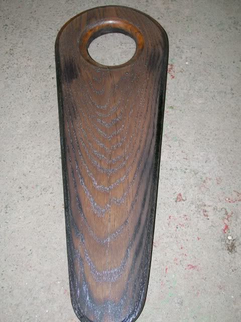

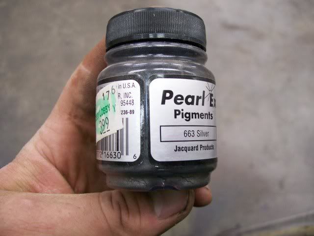

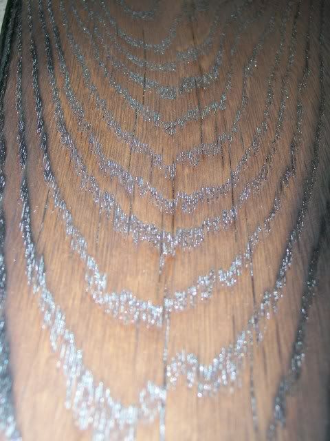

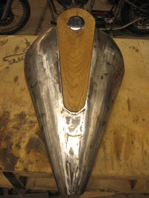

When building my chopper's gas tank, I made a recess in it to accept a piece of fitted wood. After seeing a luxury car commercial about polished wood I wondered if I could do something similar. Using some pearl dust from hobby lobby mixed with PPG clear. The mix was very heavy on pearl. Pushing the mixture against the grain worked the dust into the pores of the wood. When the clear became tacky, urethane thinner in a rag pulled with the grain took all the excess off leaving the pearl where it was supposed to be.
Now it will be Kandied red to match the stain and the to-be paint job. Taken out into the sun, the grain looks like diamonds. Kindof a neat touch for a unique tank.

I modify and refinish rifle stocks. I think that thing would looks great sanded down and rubbed with teak or tung oil - it would lend quite a bit of preservative quality to the finish.
Just one man's thoughts.

Thanks for the heads up! I will be looking into that stuff. Do you know if those products are chemically resistant? Just don't want anything reacting with gas or the vapors.
