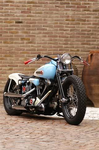

Yes, no problem, that rim above is 4" wide with a 5.00 x 16" Shenko..

Keep in mind when they speak about rim widths it's always measured between the inner beads..
A stock 16" Harley rim is 3" wide between the beads..
That pic above, as I said earlier, is 4" between the beads..(with 5.00 x 16 tire)
