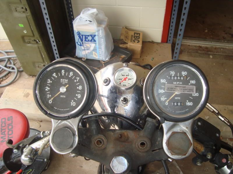

I did something similiar except using the Ammeter hole in the headlight bucket. I run a capacitor, so an ammeter doesn't really do me a lot of good.
I got the parts at a local auto parts store for less than 50 bucks. the Stainless hose is actually off-the-shelf vacuum line that I threaded the oil line through it to protect it from the exhaust heat.
