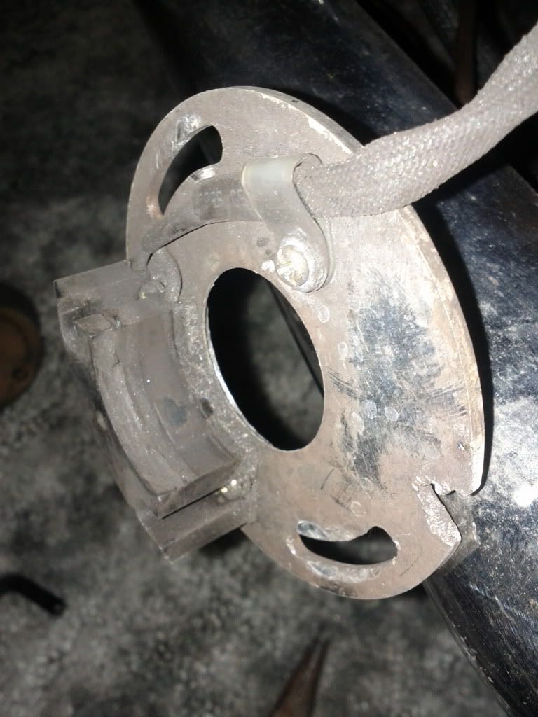

next step pull the nose cone....OH CRAP LOOK AT THIS

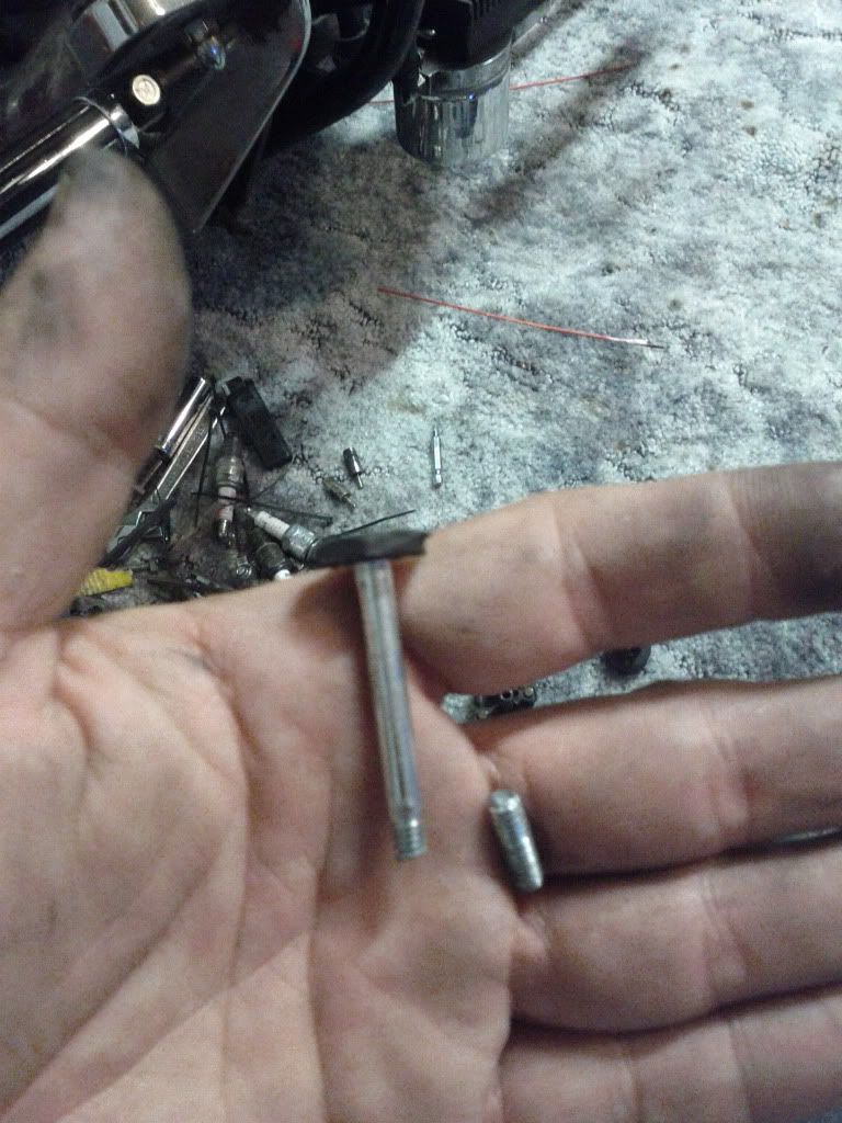

Advance spring (or the pivot on the weight) gave out, then the weights hit the cam cover and sheered the bolt.
Looks like you already got the bolt out of the cam, so why do you need to pull the cam cover? Seems like you can just put a new advance unit in (might as well, and get a quality one like the Rivera unit), and a new bolt and be done with it.

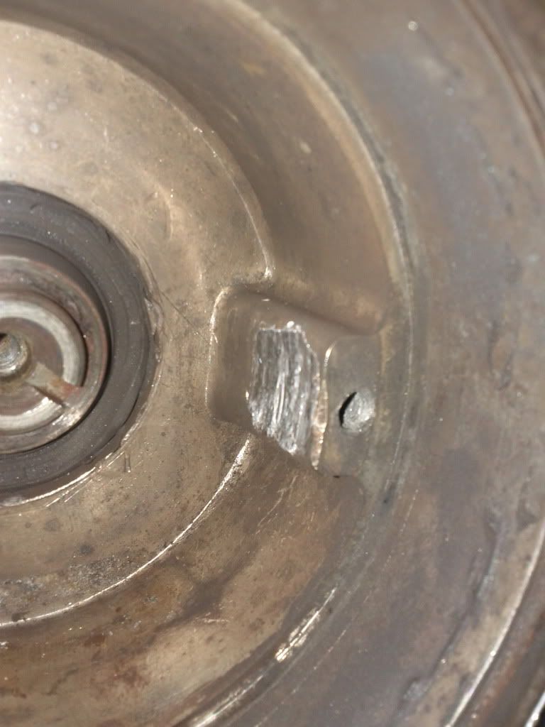

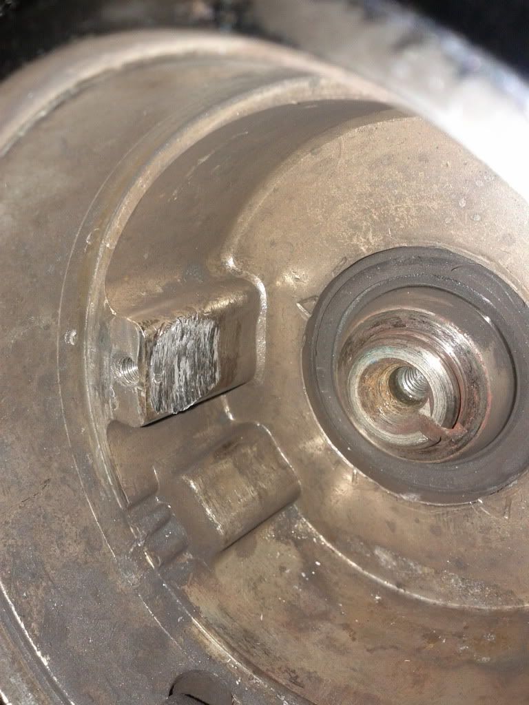

Sorry to disagree with you in public, but I think the springs have nothing to do with it. They only control the rate of travel and rpm point.
The pegs on the base and the holes in the weights are the stops that control how far outward the weights travel.
These get wallered out over time allowing the weights to travel too far and bind the cavity.
Some aftermarket timing covers also have slightly small weight cavities too.
Nothing a little preemptive grinding can't fix.

agreed, if the his weights couldn't move far enough to hit when it was new, then only wear on the advance unit would cause that (not a broken spring), which is why I said "or the pivot on the weight".
However, I've held more than one brand new aftermarket advance unit in my hand where the weights could hit the cam cover or circuit breaker housing if you spread them manually (this may have been compounded by the aftermarket housing). The unit would work fine b/c the springs provided enough tension (at least street riding) to keep the weights from hitting. But once spring(s) began to lose tension or break, then ......FAIL.
Regardless, everyone is saying the same thing: buy a quality unit, make sure it can't hit the cam cover, and keep it lubed.

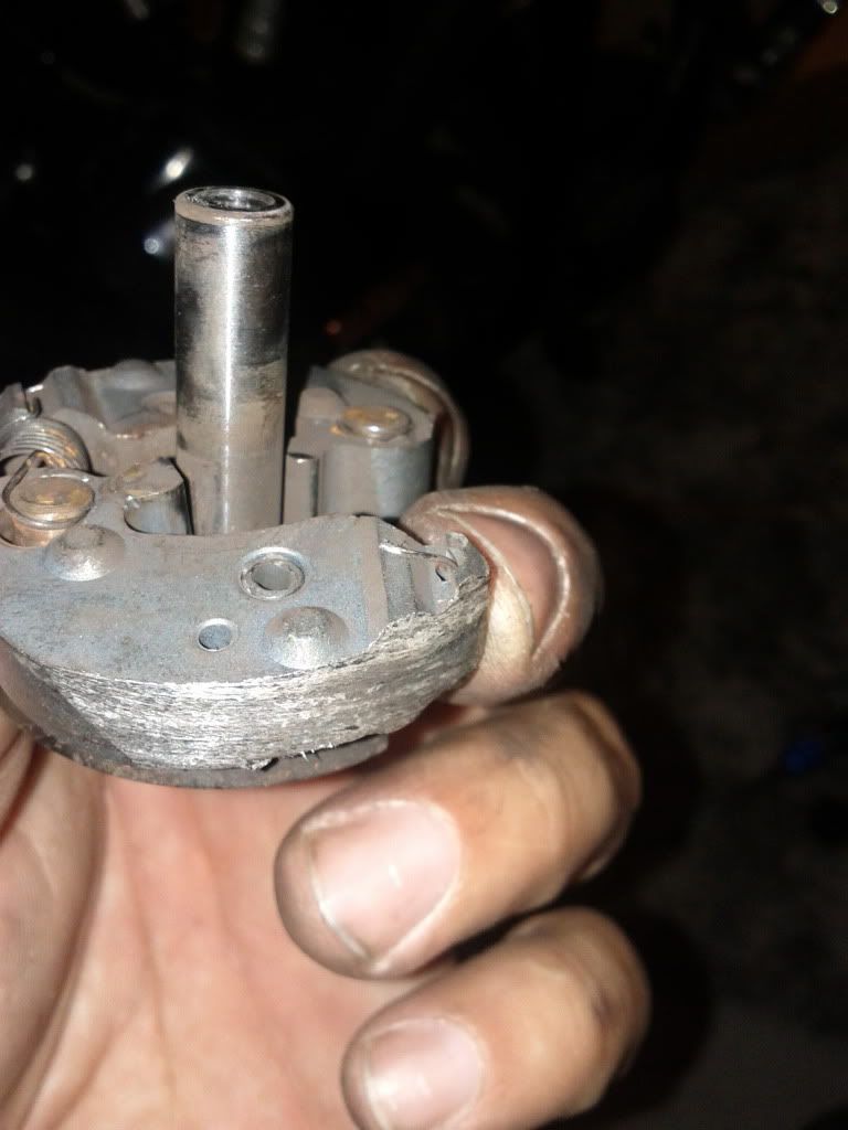

Look at photo three. You can see the worn out pin hole in the one weight. I would say that, that is what caused it. Like every one is saying. Buy the good unit. Some even have a bearing on them. Last cheap one I had, hit the cam cover, out of the box. Cheap is cheap. Quality, gets you home.
