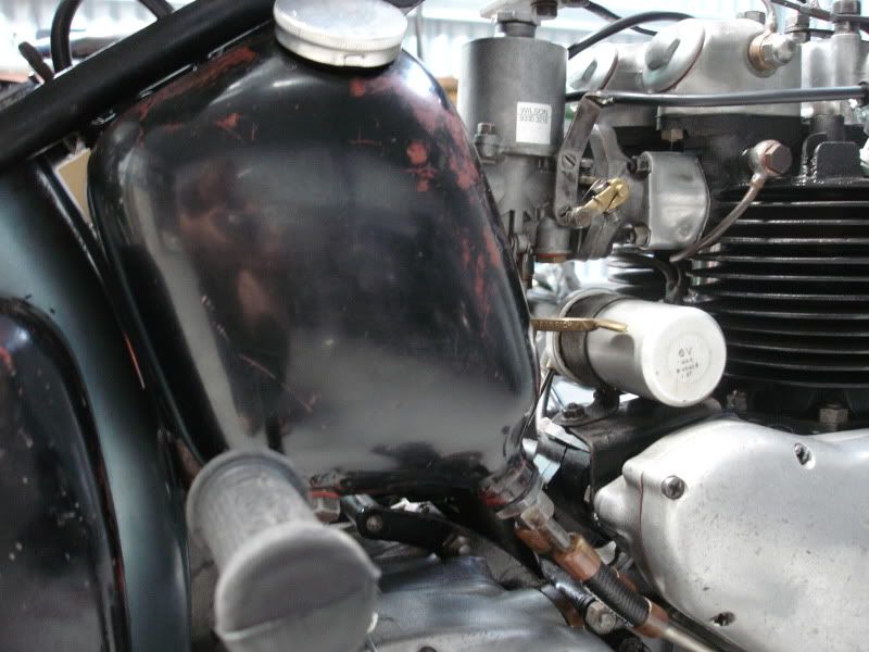

I have a 1952 Triumph 6t. I've ran two of my oil lines and having trouble with the other two. I order all the parts for the oil tank, but for the feed line I received a nut that doesn't seem long enough and no nipple to attach the line to. Does anyone have a picture of what it should look like?
The other line is the one that goes from the top of the oil tank to the bottom of the crank case and it seems like the two would need different diameter lines. Is there some sort of conection I should be using in the middle to increase the line diameter?

Hi Greg,
Feed line: this should screw onto the bottom of the filter on the tank
Top of oil tank to bottom of crank case? You mean to the back of the primary case perhaps?
Hi Greg,
oil line to oil tank/filter fitting
Top of oil tank to back of crankcase looks something like this.

Hey thanks Aussie T-bird. It's a bit tricky building a bike from a basket case, when you have no bikes to look at for reference. Those pictures help heaps and hopefully I can finish the oil lines once I pick up that oil feed connecter. I have the nut just didn't get the connected sent.
