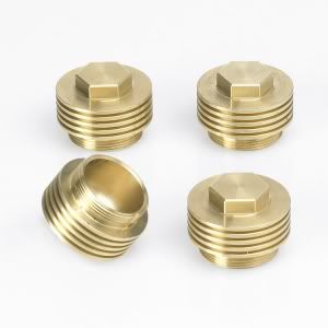

I just bought the brass finned inspection caps from lowbrow and they dont fit my rocker covers... the engine is a 71 tr6r... the caps as advertised should fit a 63-72 engine.. the threads start but the cover wont take the whole cap.. I compared the stock cap with he brass one and the brass is like .020 larger than the stock ones.. and the thread pitch doesn't match.
Any suggestions before I return them.. just trying to figure this out..
here's a pic from lowbrow

tappet caps are the same size for all unit Triumphs with round caps.
you either have pre-unit caps or there is an aftermarket quality issue.
pre-unit caps are about a 1/4" larger in diameter.
