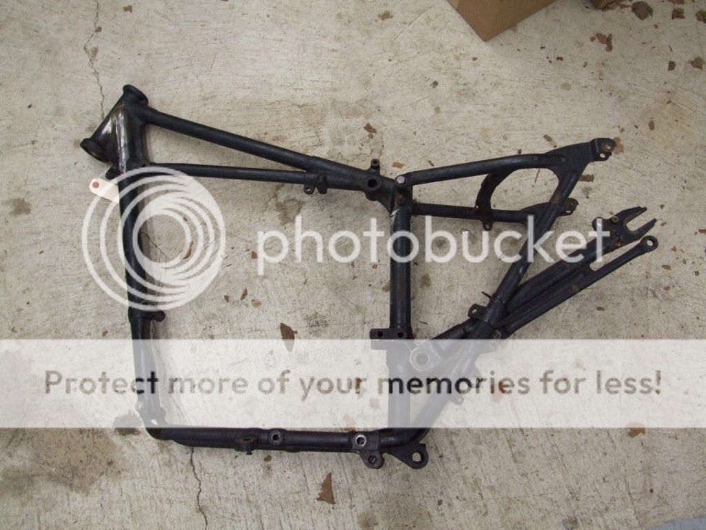

Not really all that hard man I'm in the process of doing the same thing now because like you I like the single down tube frame. All you really have to do is reconfigure the center down tube and make a mount to accept the motor mounts. Kinda like this.
