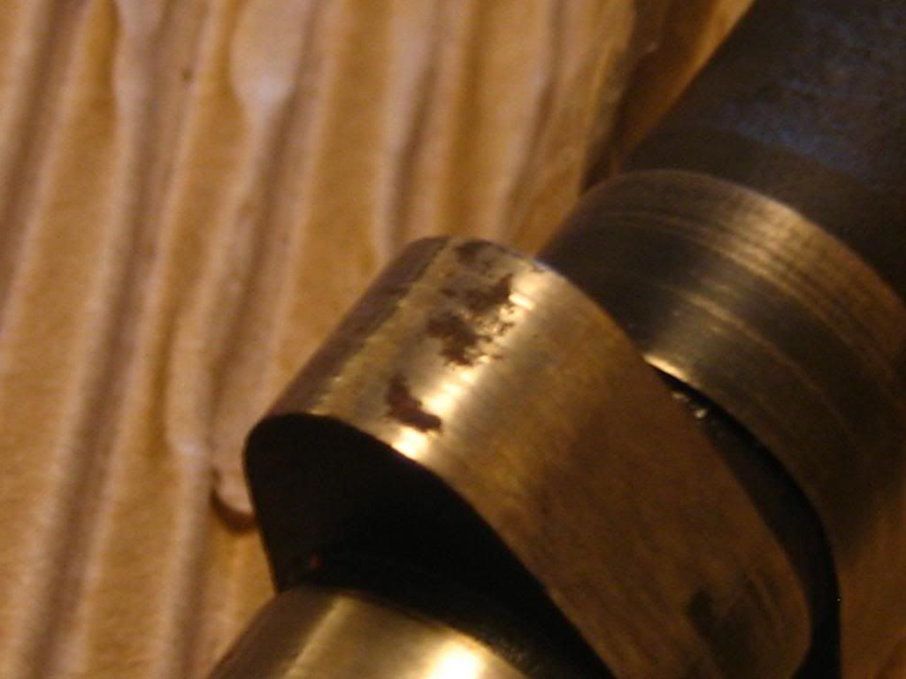

WTF! is wrong with these people, so the 'usable' cams arrive from fleabay seller. Staining i can live with, pitting on the lobe is just totally FUBAR.
'call if not completly satisfied, don't post negative feedback', Damn right you'll pay return shipping if you want this piece of crap back.
J*sus f*ckin' H Chr*st these tw*ts give me the dry rots.
rant over.
Did you use PayPal? If so just complain and you'll get the money returned..
