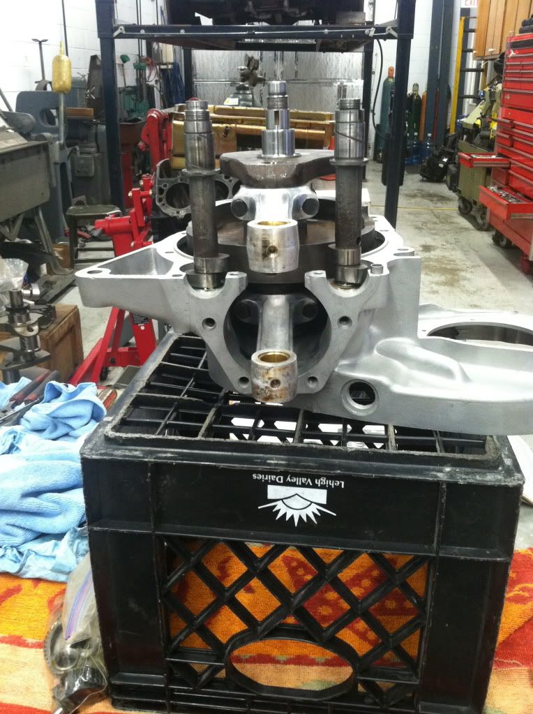

I doubt this helps but here is a picture of the cams in place before I closed the cases and assembled the transmission
a lot of discussion on this subject, obviously there has been many Morgo kits put on 65 through 68 Triumphs before and lived to tell about it, yes some cam wear will happen but other factors come into play, like the condition of your cam followers, cam lube on break in and the engine oil you run.
Bottom line try it and see what happens, after all many of the nitrate hardened cam were not done that well anyway,The Megacycle cams are hardened better than stock ones were.
