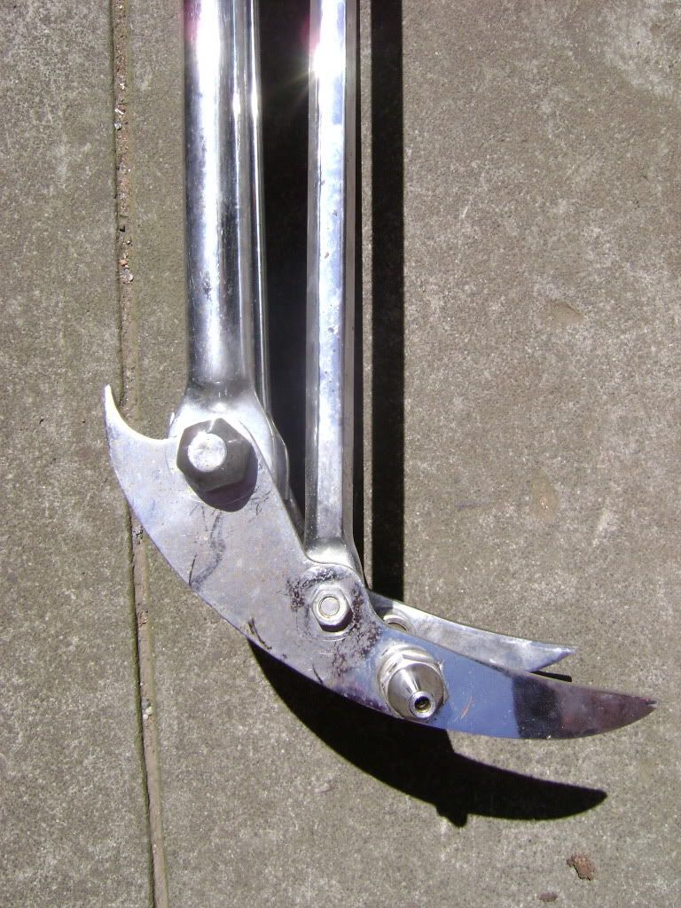

"Fury"
..rockers are homemade (and scary..)
And spring rods are bolted on the bottom to the perch..I guess that was done afterwards..
Unfortunately at AEE we sold our rockers, both the fishtail and crescent, and I have seen them on all kinds of POS.
Sugar Bear is right not to sell them separate. Also a whole lot of the old springers I see show up on here weren't worth a damn 40 years ago let alone now. Be very careful what you tie in to.

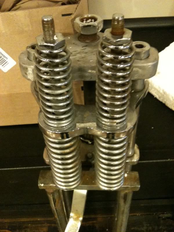

Heres some pics and numbers If anyone can help with who built them. Numbers are 0333 follow by the p inside a diamond shape as then numbers 02-472.Thanks to everone.Peace.

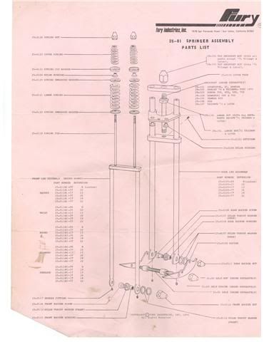

Hardtime - like Danny F. said - it's a Fury. Looks like the rockers are (dangerously) modified originals - front and back has been ground down, a bit too far.
Here's what Fury rockers look like. Also someone's drilled holes in your top tree to mount Harley bars, instead of using the integral mounts, and the bushes in the legs will need replacing - I think they're 5/8 x 3/4 x 3/8, and 1/2 x 5/8 x 3/8 inch (O.D, I.D and width) oil impregnated brass or bronze, I forget which.
