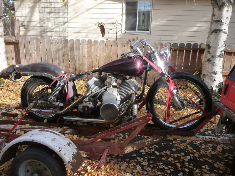

I have one I picked up a couple of years ago. I have the engine torn down right now it got some moisture in the back cyl not froze up but the rings was toast cleaned up with a hone.
Has roller lifters Howard billet cam roller rockers. TRW forged Pistons Childs and Albert rods. All put together with ARP hardware. Somebody put a bit of money into this eng. I need to get off of my lazy ass and get it put together. But I have my Servi and Shovel projects ahead of it.
Here are a few pictures of what I started with.

Thats a cool looking Ride you got there Sno Dawg. Do you have any history on it? What is it titled as? Looks pretty complete. I bet it is a torquey SOB.
I haven't had it running which is a good thing because there was a lot of hack work on it. Hell they took and had the coil wire to the Dizzy Grounded to the frame. The oil pump mount stud was cut off so that there was only 3 threads engaging in the bearing cap (it uses a standard Chevy oilpump setup).
It is titled as a 1990 Santee.
