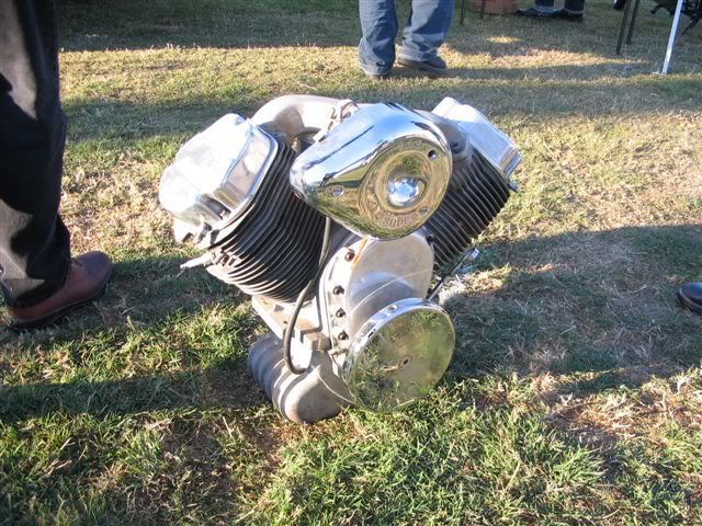

If you look close at the kick start pedal you'll notice it is muddy. It is ready to start now and has gas in it. Because the engine is new and it is an actual 100C.I. it wore both me and my bike mechanic friend out.The good news is it is in time, getting both spark and gas. It just needs to turn over faster because of that long intake.
Because of the position of the clutch release lever I had to use an open primary and jocky shift. That put the release arm right where the bike starter would have mounted. My next move will be to try and adapt a Chevy starter to it. I have a Spyke HD starter but I am not sure it can hold up to this engine???
Hopefully it will be doing its break in miles before December. I'll be gone for a couple of weeks at the beginning of November is why I say that long.
Tried to see if an adapter for my Spyke starter mounted to the rear and engaging the starter ring between where the chain rides might be the hot setup but it doesn't allow my starter shaft to be in a concentric position despite the open space.
So what I am going to do is re-mount the original inner and outer primaries and mount the starter in the conventional position. As for the Jockey shift, I am going to take the current shifter arm off and mount a short arm to the ratchet wheel that way I will have the option of using a shifter that comes up next to the tanks or a foot shift if I redesign the shift arm. The easy route would have been to get Bakers hydraulic trap door, but when I started it wasn't around.
That is ok when I am finished it will be right, no sense trying to rush things.I am also considering mounting one of those lever arms to eliminate the stock solenoid and avoid the problems the older versions had of welding together.
I have also become informed that on the Generation III's that there is an oil starvation problem at the rear rod journal but Jim Fedor has solved that with his genius and the need to drill two small holes about 90 degrees from each other, milling a small slot and plugging the original bleed hole. This fully pressurizes the journal and the rest of the oiling system is great already as is. Just a small thing that needs to be done to perfect the engine.
That said I will still be able to fire it up initially on schedule. Go back a page and click on the link in post #60 showing Jim's bike in action and you'll see the effort is worth it.
No..... I wanna see YOURS run...
You will soon. I should have the inner primary and outer primary on when I get back then I can mount the starter. If the engine weren't so tight it would start now. Kickin something over that big is not a good move.
I can almost get it to start now but it needs to turn over faster.
