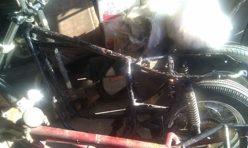

I picked up this lot of BSA this weekend. Sorry for the stupid questions in advance but i'm a bit green with beezers! From what i can gather the 2 "rollers" are mid 60s lightnings and the frame is some kind of A50? It looks like the reddish one has been raked a little, i'll degree it when i get it stripped. Are the necks the same on all these? I ask because i want to grab the bsa fork and rear off the raked bike and throw it onto one of the others. Is there just one size neck up until the oif's?

the frames with the open rear seat loops in your photos are A65 Frames
cant tell in the photos about the red primered frame though, could be some kinda fucked up frame, should have 2 downtubes
1,826 Posts
The red frame does have two front down tubes...I think the angle threw you off :cool:
It does have 2 downtubes, its just the angle. Thanks man!

Thanks a ton guys! 1 a50 and 2 a65's. I ended up taking the a50 frame, 2 bsa wheels and the fork. I'm selling of the rest in order to buy a new tank and hardtail. I have a small unity spot and a Ford spare ring(fender) so am hopin to get this thing going soon. I'll throw up a proper classified post in the coming days for the raked frame, oil tanks and some other things i need to get rid of.
