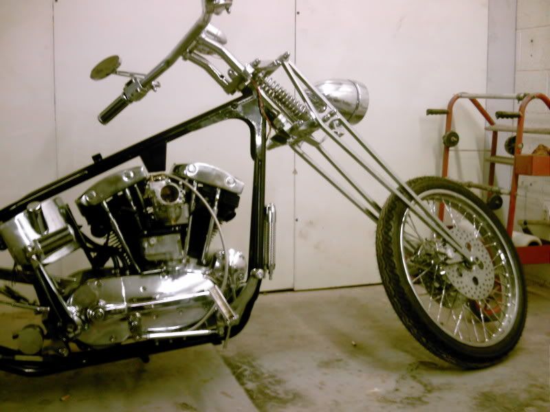

I just welded a short piece of rod across perpindicular to the backbone on top. The pads on the springer hit the rod when turning sharply in each direction.
I was going to tap each end and install some brass button head screws in the ends of the short piece of rod...but never did.
Here is a pic....super simple and effective. Nevermind the tank paint..I changed it. ha ha.
^^^ That's what the Paughco frames come with. They're threaded to run a button head like Wagoneer was saying.
yep..that looks good
Depending where the springer hits the frame, you can drill/tap the frame for some small buttonheads so the springer hits them instead of the painted frame.
I prefer internal stops though. Some springers need to have the springs removed in order to drill for the screws to secure the plate to the bottom tree. Or you can weld the plate on.
