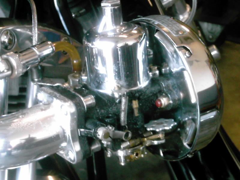

I have a '75 FLH and I put a CV (Docbuilt) on last year and I'd never go back to anything else. $300, put it on and forget about it. You wont believe how much smoother it'll run and it will improve you MPG. I have a small aircleaner on (I didn't want to cover up the motor). Here are a couple of pictures.
This is what it looks like from the side. It doesn't protrude out much so you don't have to cock your leg around it:
This is the aircleaner on the old carb, but I adapted it to use on the CV so it looks the same.
