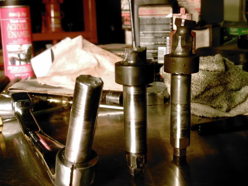

The flywheels are pretty tough...As long as the tapers are not ate away...
These are 45" wheels that was stored at the bottom of a well for twenty years...
Did a bead blast to them....Got some really deep pits going on..
Was going to put them back in service, but found a better used set to go in the build....
What you are dealing with is nowhere near as bad as these where in..
