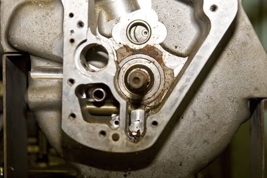

3 or 4 years ago I picked up a delcron lower end to make a stroker. Put it in a plastic box and put it in my garage to wait for me to get the money. You guessed it, I put it under a hidden leak. And water somehow got in.
I am ready to start it, pulled it out and found this mess. I do have some mechanics I can talk to, but I am wondering what can be saved and what is just a lost cause. And what I can do to start the process. Funds are still limited, so I will do as much clean-up as I can.
This sucks, is my stupid fault. But, I do need to make the best of this crap.

Take the cases apart and scrub off all the steel parts with WD40 and a green scotchbrite pad. If you are lucky most is just cosmetic damage. Look for deep pits as they can become stress risers and always get new springs.
2,526 Posts
I've seen a lot worse cases brought back to life. Looks ok to me. Strip it down and maybe soak the rusty parts in vinegar, seems to work well for petrol tanks so it should clean those up a treat and then just replace what you can't salvage.

You must be sick, because I am. I have had similar things happen, but never a motor, or that bad. Bead or water blast the wheels and rods, replace the bearings and anything deeply pitted. Just remember, it would be better to put it back away(of course in a confirmed dry spot) and start the buying process all over again. If you try to "get by" with using any of this, you will pay again, and probably through the nose. It is things like this, that teach us a lesson. The School of Hard Knocks diploma is in the mail.

Looks like stock rods are in it...And perhaps flywheels...
To me ....Those Cases are screaming for a 4-1/2 stroke...S&S Rods or H-Beams and a 3-5/8 big bore....Sweet 93" motor by the time it's all put back together....

I'm with Drag on this one, toss the crank and go with a 4 1/2, bore out the jugs, upgrade to evo lifters and for the price of a new twinky you could build a shovel that'll smoke em.
398 Posts
tear down, have the crank & rods bead-blasted & re-polish the journals. add some new bearings & you're back in business. thoroughly clean those oil passages with a bore brush.
the white pistons, rings and valvetrain are garbage unfortunately. but the big parts will probably clean up just fine.

Looks like it really could have been much worse. There is a bit of light pitting on the cases, but not bad. There was still assembly lube on the bearings. And the whole rotating assemble started to move freely without even grit after I got off one side.
Can anyone look and tell me what specifically I have for rods or flywheels or pistons?
And what does the vinegar do? I have a friend who does electrolysis on steel where he just washes off the rust. Would that hurt anything?

I didn't know Delcron cases worked with early (roller bearing) flywheels.
The casting numbers on the flywheel has #####-41
Harley used this number from 1941, all the way up to 77 until they went to the 80 inch wheels....The 80" have a casting number that ends with -78
Those wheels are FL 3-31/32 stroke....74 cubic inch.
Kinda a shame for them to be in those Bad-To-The-Bone cases...
Also .... A look at the deck surface shows alot of meat...These cases are for the stock bore jugs of the FL's 3-7/16" or 80" jugs (3-1/2" bore or .060 oversize of the 74" jugs)
Again.... Begging for more...They are...!!
3-5/8 jugs is just the perfect bore size for them....If they was Hi-Deck cases from Delkon they could support 3-13/16" bore... I have done that bore on the stock deck height Delkon's and Stock Harley cases...Not much meat is to be seen at the center of the bores..
I don't recommend doing that bore size unless Hi-Deck cases are in use....
The below photo show how thin the case gets to with the 3-13/16 bore...
These cases are Harley.
And did blow up in that section.... This is a repair that has been done...
The insert was made from steel without a bore going all the way though...As it once was...
The Delkon's would have a better chance of staying together with this HUGE bore being their casting is super thick....But would be the same in the area of between the bores. Unless Hi-Deck cases was being used.
