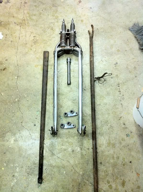

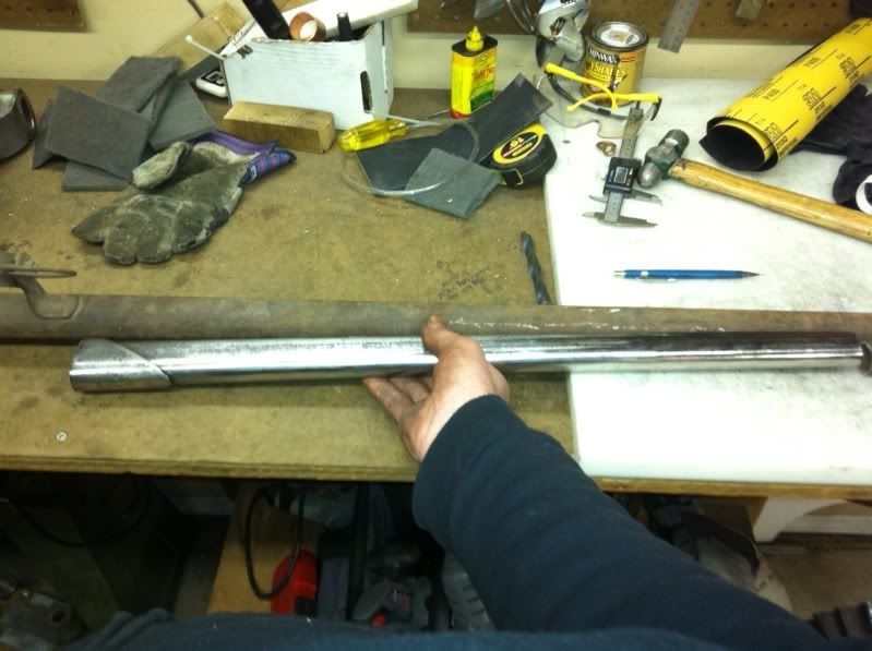

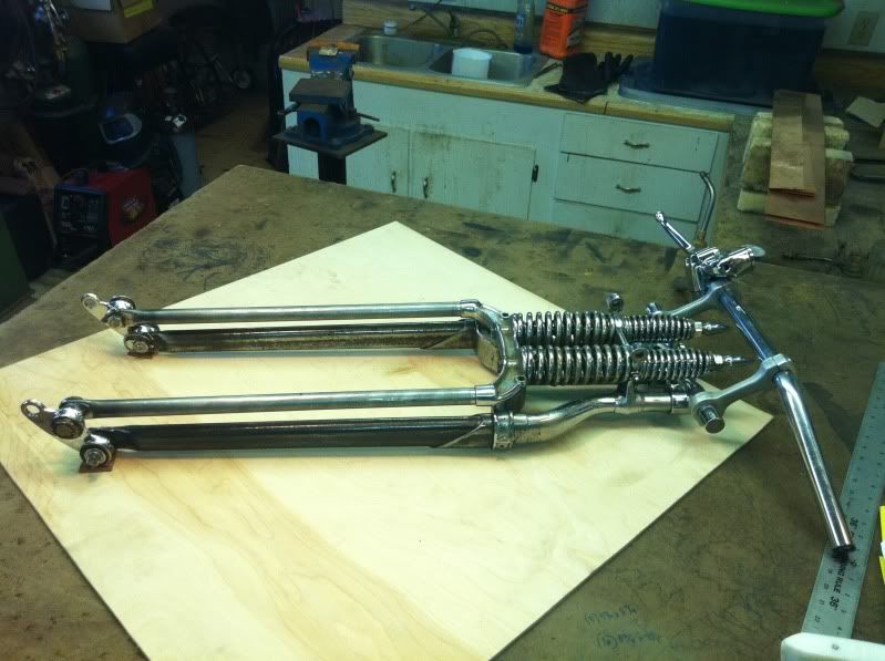

Bought it off of Ebay. It was a crooked pile of junk. Lots of good parts. Made it into a 1" stem first. Then cut off the legs and made my own. Model A radius rods for the primary legs and .875" X .130 DOM for the fronts. Lots of work, but well worth it. What do you all think?

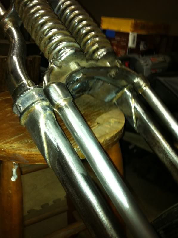

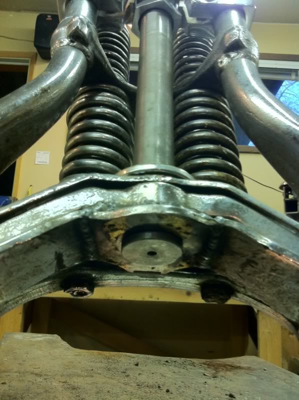

I am interested in the details of how you attached the rear legs? Looks fantastic ! :cool:

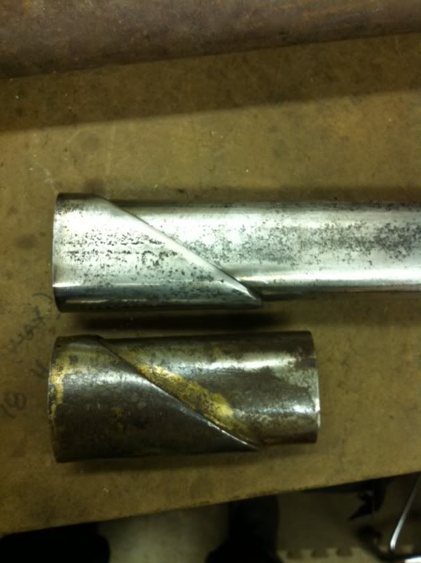

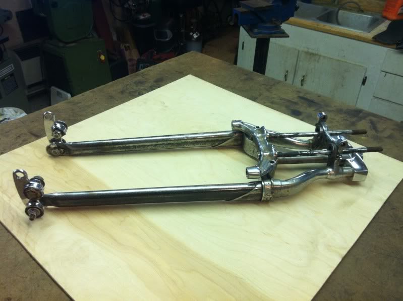

I welded together two six inch pieces of solid steel round bar, inserted them up into the trees and plug welded them. They extend into the legs about 3.5", where they are plug welded again. You can see the slugs in the pre welding picture.

Dumb question? How did you get the solid round bar/slugs centered in the oval tubing of the springer remains and radius rods?
1,576 Posts
Scott, i think the slugs are made to locate themselves in the oval being 2 pieces of round welded next to each other.

Cool, I see them now. I was thinking you probably did that but I had missed the slugs in the pic. Thanks for the write up and pics. :cool:

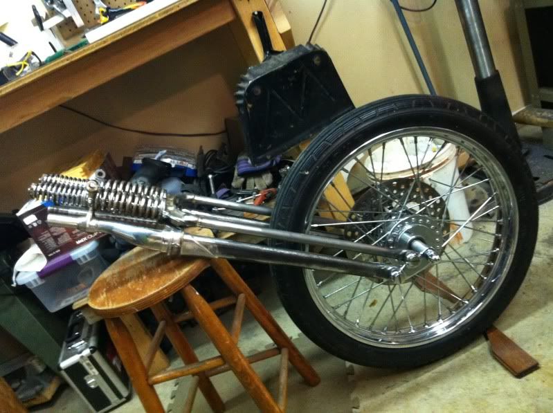

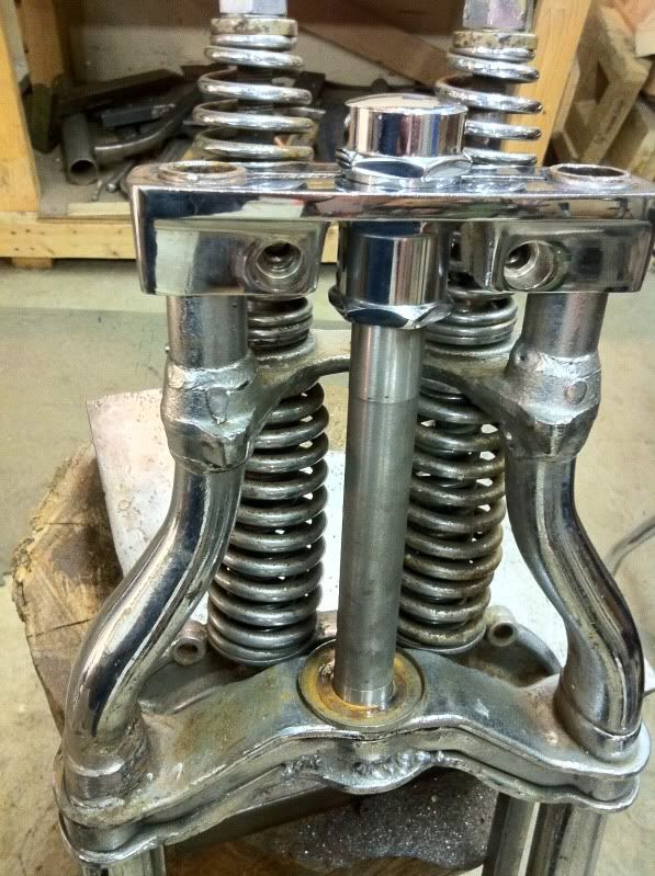

that's awesome, how did you compress the bottom springs to get the top ones and the rod through?
I've done it several ways. I've taken a ratchet strap, and used it to pull up on the axle to relieve the springs. I've also used a c-clamp to compress them. They are under a fair amount of pressure, so you have to be careful. Good luck!
