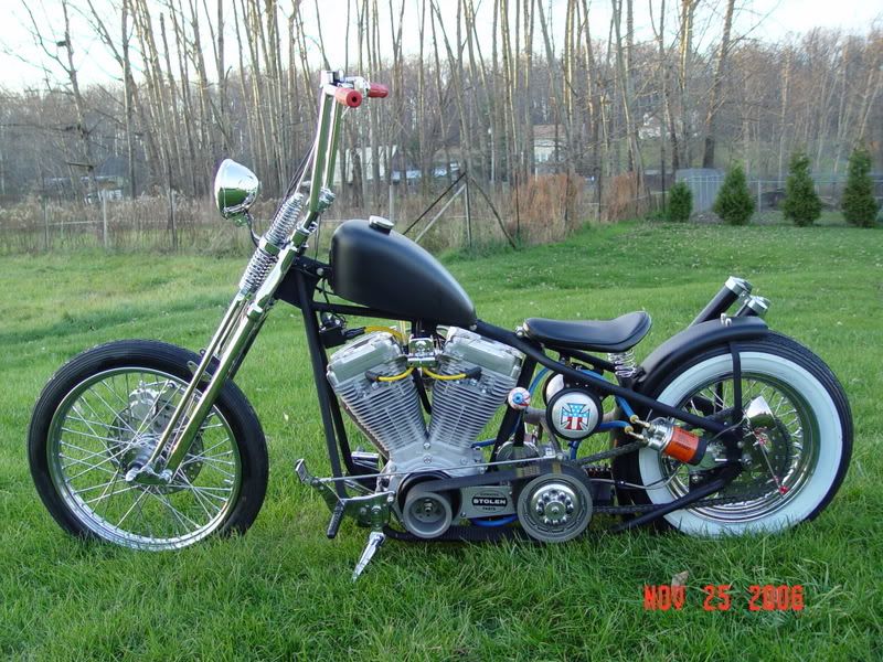

Heres an aftermarket filter in a Santee custom frame w/650. The frame has about a 6" overall strech. It's installed into the return ling along with a power steering type oil cooler. Has about 20K miles on the set up and it's worked graet. It uses a standarh Harley filter, either chrome or black.
Click the link below to see my set up on my 67 TR6
http://i51.photobucket.com/albums/f369/baasmetalcraft2006/My67Trump.jpg
was that the Trump that you just picked up? when did ya chop that baby? looks good, thats for sure
Yep that was the one I picked up last winter..Wouldn't be right If I didn't add my own touch to it!
