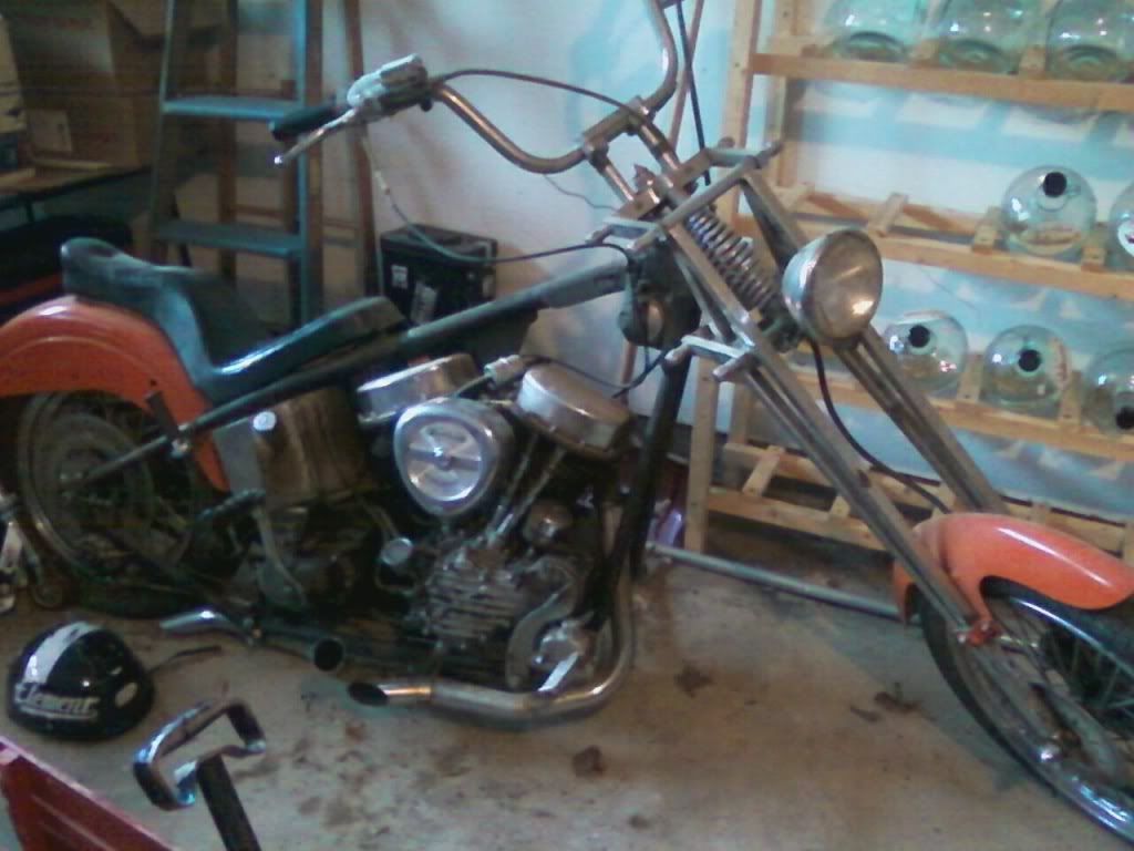

This is my 1950 Panhead chopper. I want to make it into a 1960's style bobber. So I'm gonna start with a frame. I don't even know what to start with in order to save the money to buy one. & I definatley need to save the money.
This is a very cool girder front end. Hate to take it off, but I just cannot ride this bike! I will rechrome and hang it on the wall for abit.

Hey thanks for the envy. But it hasn't been started in 5 years or so. I bought this bike back in 2000, only rode it once, while I was pregnant, let the ol man ride it for a few years. He got a fatboy, stopped giving my pan any attention and recently left me. So now I'm gonna make a bobber. God, he's stupid! The frame is aftermarket and really need something easier to ride. I am only 5'2" and I want to have complete control (don't all women want that?) So the frame has to go.

Could someone educate me on that air cleaner cover please???...I have never seen one of those...just curious about it...
My thoughts on the build...first, don't re-chrome that girder...polish it up (you might be suprised how nice it comes out) and then hang it on your wall if you want to keep it...if not, do as the rest said and sell it as a roller to get the frame and front end that you do need...then, after that, figure out exactly what you want and then start getting parts...there will be plenty of help on here whan you need it...

Chicago, look for a 30* stock frame (o rake, o stretch). They're super common, made by everyone, and make for a compact, easy handling bike. Front ends can be anything you want obviously but a narrow glide will be smaller, nimble, and likewise super easy to find at cheap prices.

Hey guys, thanks for all the advice. I do have a title for the motor, that says classic with serial numbers. The frame has no number as it is aftermarket. The air cleaner? Got no fucking clue. Something the ex-ol man picked up in the back room of a parts shop. I hate it! I will look for that smaller frame. That is exactly what I want.

Air cleaner is for a Rev-tech carb. They were sold for awhile back when. It's likely the Rev-tech carb under it. They are kinda funky carbs, with replaceable venturis. I think they went as small as 34mm and as big as 44 or so.
Your pan motor should be fairly easy to start. I hope that it didn't get the compression ratio raised, but more than likely it's just wet sumped and full of oil. I'd start by pulling the spark plugs and the timing plug, spraying some kinda oil into the chambers and kicking it with all the plugs out 'til it pumps all the oil out. It might be easier to start than you think.
