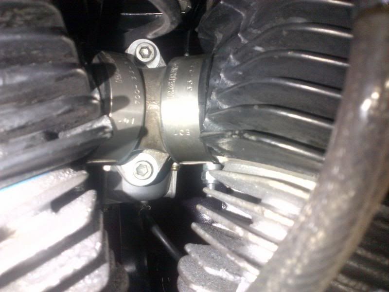

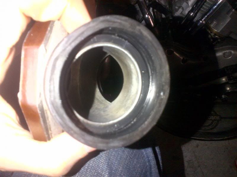

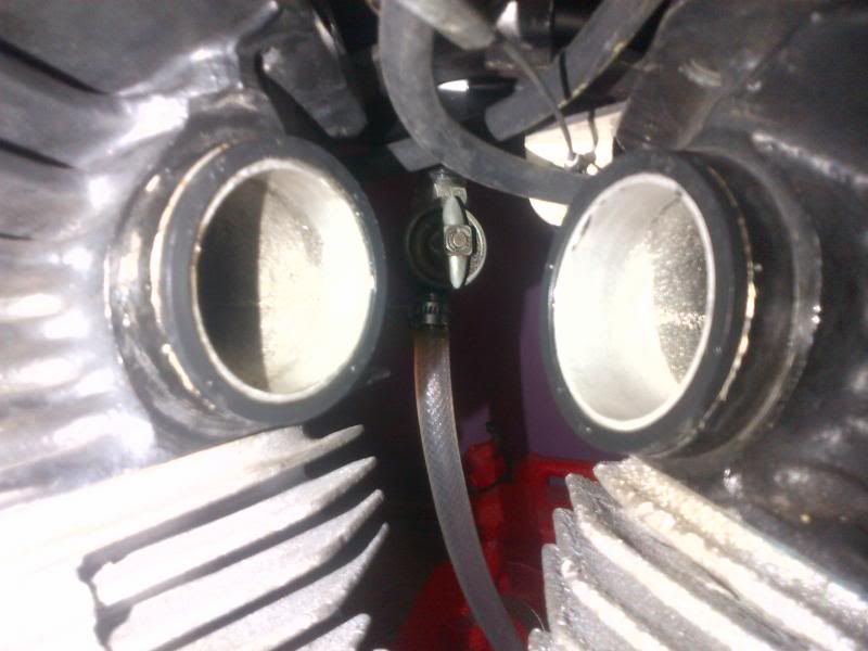

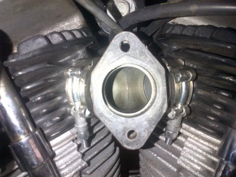

Discussion Starter · #71 ·
So I mounted everything like showed in the pics and rode about 5 miles with some occasionnals POF! from the carb but less than before.
Then I had a big POF ! and the bike died.
The intake had been expulsed from the rubbers and the carb was just hold by the bracket.
I remounted everything on the side of the road, noticed the rubbers were damaged and the plastic rings all messed up (not flat anymore, like if the heat curved them). couldn't put the plastic rings back on.
Rode back home at 10miles/hour, everything went fine.
I dismantled everything and decided to put the old rubber (round) under the new ones instead of the plastic rings since I don't have any left.
I rode about 1/4 of a mile and had a POF !
The intake had been expulsed, less than last time but still...
Now my rubbers are really damaged and I don't really know what to do next with this problem that is giving me headackes. :mad:

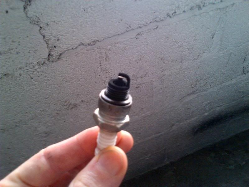

So here's the plug from the front cylinder, kinda black so I guess I don't run lean.
Maybe a timing issue or a valve.
Maybe I'm wrong but was thinking if the intake got expulsed or rejected, maybe it's because there is an explosion while the admission valve is still open so the explosion happens in the intake also causing it to be rejected...
I'm gonna check my pushrods and ignition next I guess.
