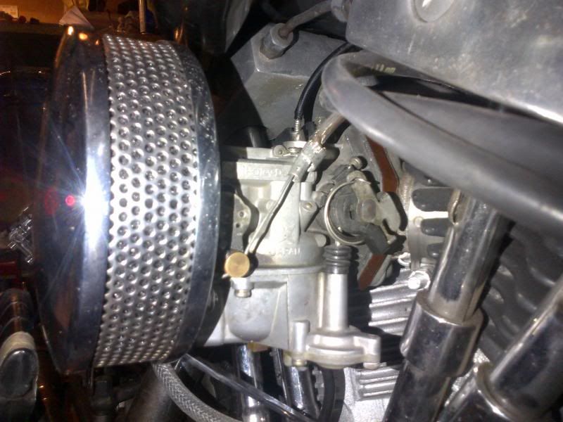

So anyway, I've got a leak at the front cylinder admission pipe, the rpm drop when I spray at idle, and if I spray a lot, I even managed to shut off the engine

What do you guys recommend ?

I did put new seals about 1000 miles ago, so I assume they are ok, do they happen to move or something? I'll take the whole thing appart tomorrow, was in a hurry today.
the brace that hold the pipes has this screw and it seems a little weak, maybe this is fucked up, cause I couldn't tighten it stronger...

So I installed these clamps
but I still have the same problem. (maybe I installed them wrong ? seeing my skills, it's possible !)
I figured I could post a video of my problem, maybe it'll explain my problem better and someone here will know what's goin' on
The sound isn't great, but in this video my problem appears at second 16, second 29 and second 36, you can see little cough from the carb and hear it if you pay attention. (in reality the sound is way more hearable)
644 Posts
Discussion Starter · #45 ·
I think i have a Keihin carb. Is it the same thing as a bendix for the jets?
To be honest I'm not impressed with these clamps, but maybe I didn't install them properly. When I spray the cleaning stuff near the admission it still turns off the engine. Should it be totally sealed or is it normal for it to let air pass thru when you spray right on the clamp?
I first install them with one adapter ring on each side, then 2 (one on the pipe, one on the cylinder) but it didn't change a thing. Should I put three on each side? (there is 6 or 8 of them in the pack)
