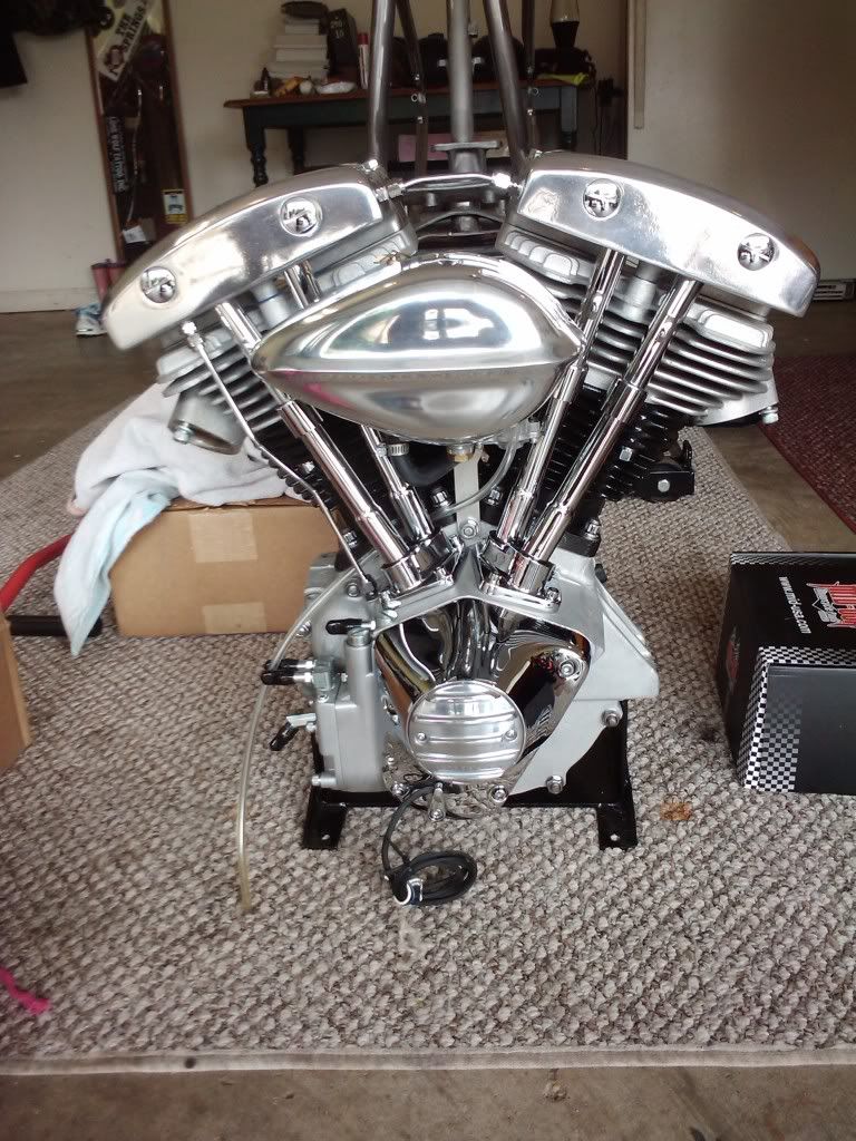

Greetings all, In the very near future I will be heading back over to the shithole (afghani land) for 12mo.
It will be somewhere around 18-24 months before I can get back to my shovel project
What is the best reccomendation for keeping the guts of my engine/tranny serviceable and corrosion free.

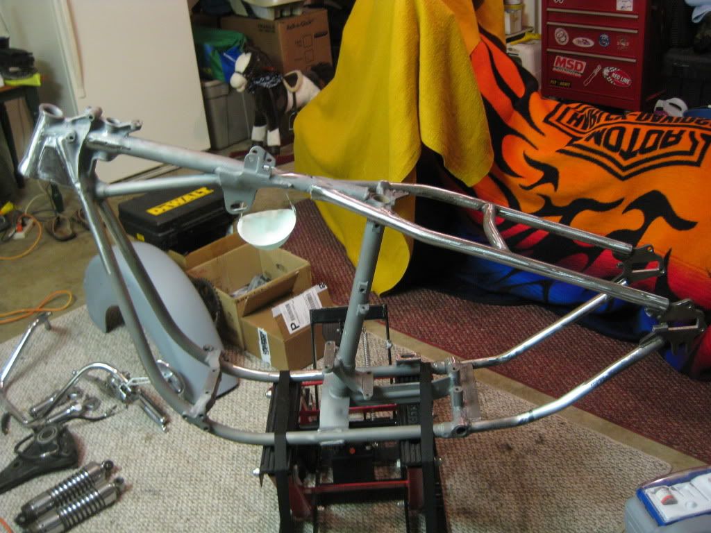

I also have my frame in a bare metal state
any ideas would be appreciated, Thanks much

I would fill then up with desil, that will keep condensation out, and spray them down with it as well......Roach.

Simple Green on the external stuff. Washes off with water and soap, and keeps rust and aluminum oxidation from forming. I would shoot primer on the frame, even if you had to strip when you return. Or you could ship to my shop, and I will polish daily and return them when you return from protecting our country. Thanks for your service, and If I can give you any help when you are here or over there in country, let me know. I pack a pretty good goodies package for you service guys, and it is all free.

spray it with wd-40 and put it in plastic bags with a can of dessicant.no air -no corrosion . 12 months isnt that long of a time for parts to be stored , but will seem like forever to be away , good luck and be careful . and thank you very much
