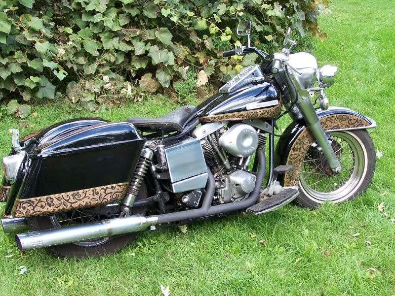

I just got everything buttoned up this morning and went for a ride in the snow :0
Well there wasnt a blizard in the forcast!
It will take a little getting used to the way the bike feels now, but Im happy w/ the outcome.
jeff
sweet lookin scoot jeff.
Yeah that seat looks great!
Thanks guys Im lovin the way it looks too. Just changing the way the seat was mounted made it look 20 yrs older.
Heres a pic of when I had it mounted solid to the frame, not bad but the pogo has the look.
jeff
