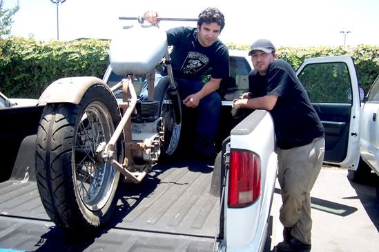

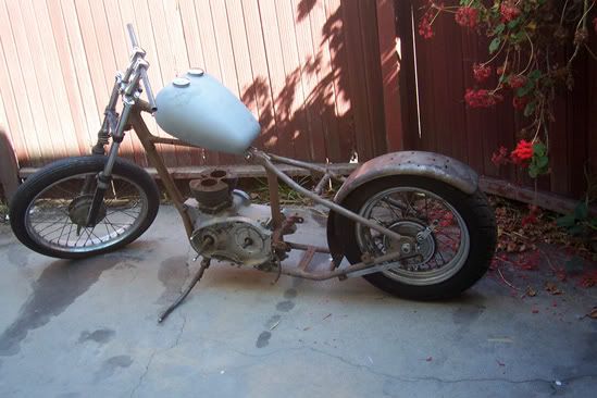

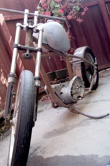

Well, it's far from new, but scored this 69 tr6c from Matt the Rat over at Jimmy White's. I've been looking for a triumph project for a while, something I can build from the ground up. Yesterday Kutty pointed me towards Jimmy. So we hauled ass down to Circle City Hot Rods. Jimmy was happy to see it going to a friend and already offered to give a helping hand when needed. This is my first triumph so any advice would be greatly appreciated.

AJH said:
what the hell is that on the back a 160? (I heard fat tires are out for the foreseeable future) hardy fucking har - nice acquisition - good luck from Jersey
No AJH, it's a 130.
