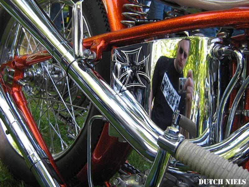

Not sure how tall of a passenger you planned on having on the back, or what your pipes are like, but almost every old frame ive bought, has had peg mount tabs welded just behind the tube where you would mount your solo seat springs to.
Heres a few pictures. The last two shows how comfortable...ish it looks with them where they are.
I didnt take any of these pictures. most of them came from this board over the years.
First, what kind of bike are you needing to put pegs on, BT or sporty or? My rigid sportster has mounting tabs in a similar location as the pics above. I remember the first lady I had sit on the back when I was a kid, damn that was cool!
Irish Rich once posted this set up from Dick Allen and I think it's freakin' awesome !
Sidenote: Also notice that Dick's rear footpegs are actually bolted through the rear of his horseshoe tank. Joe Hurst has that oil tank now....
