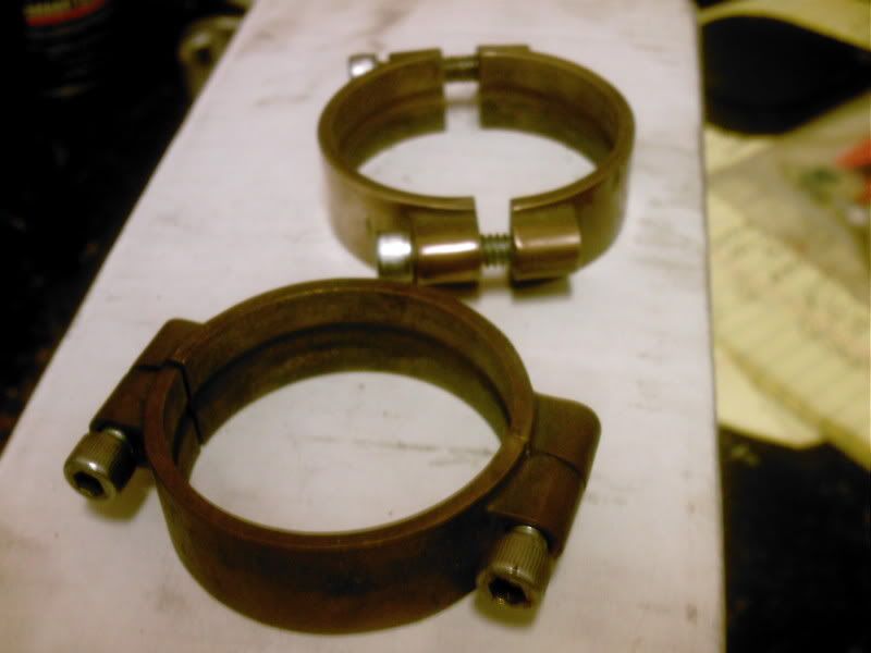

Here's what overkill clamps can do for you.
....Cotten

Say Cotten....
Looking at the seals with the two tits sticking up...Kinda wondering if it was running the two piece clamps that Arlen Ness had out a few years ago....
I had a set of them on my Pan/Shovel....Did the same thing as the photo you showed...
Went to SS aircraft type 360 degree, full contact all the way around the seal...
Those are the shit....
