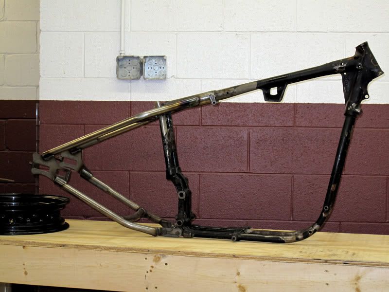

santee hardtail section all welded on. Stoked on how good it looks

I was thinking that those plates were off or for them to be level the frame is going to be kicked up in front. DEADENDBRIAN put some brakes on the front. Trust me its not a good feeling when a old man starts to pull out in front of you and you stomp on the rear drum and it locks up

Not many on here will dog you for cutting up, a cut up 67 frame. So that is history. I am one of those guys, but the ones I don't own, are not mine to say what they end up looking like. Plus, the more that get cut up, the more mine are worth. Plus, I love the hardtails anyway. Good start. If you are going custom, and you are, I would use a disc frontend. The drum looks good, and they were on the stock one, but the disc will work much better. And remember, you can stop twice as fast with the front brake. Just don't try it on wet roads or sandy spots.

I'll be the one. 72 & up frames are a dime a dozen, you fucked up.
Look at the original frame. It was already cut up. So he did little to ruin it. The PO,or previous PO, cut tabs and drilled the backbone. It is usually me, who gets upset when someone cuts a OEM early frame. But, once it is cut, it is no longer original.

yeah your frame wasnt worth that much anyway
I had a 1960 frame on here that was just ever so slightly cut in a few places but still in very very good condition
I listed it on here and no one even made a single offer on it
and I didnt list it for much
so no worries there
I think the hardtail looks very good on it
keep at the build

Thanks for all the replies. If this frame had been closer to stock condition upon buying i would have saved it. But the reality is that it was cut, drilled, welded, and even had bondo caked up by the seat. Not much to salvage and I wanted to keep the motor and the frame together seeing as those are the only 67 parts on this bike....
