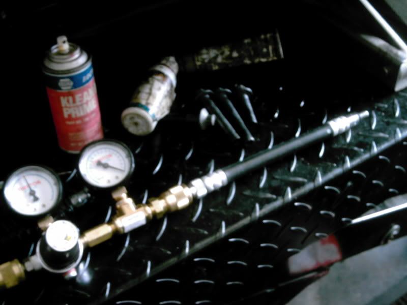

Do you have a leak-down tester...??
Best to take that out of the equation...first off.
i do not. where would i come about one?
