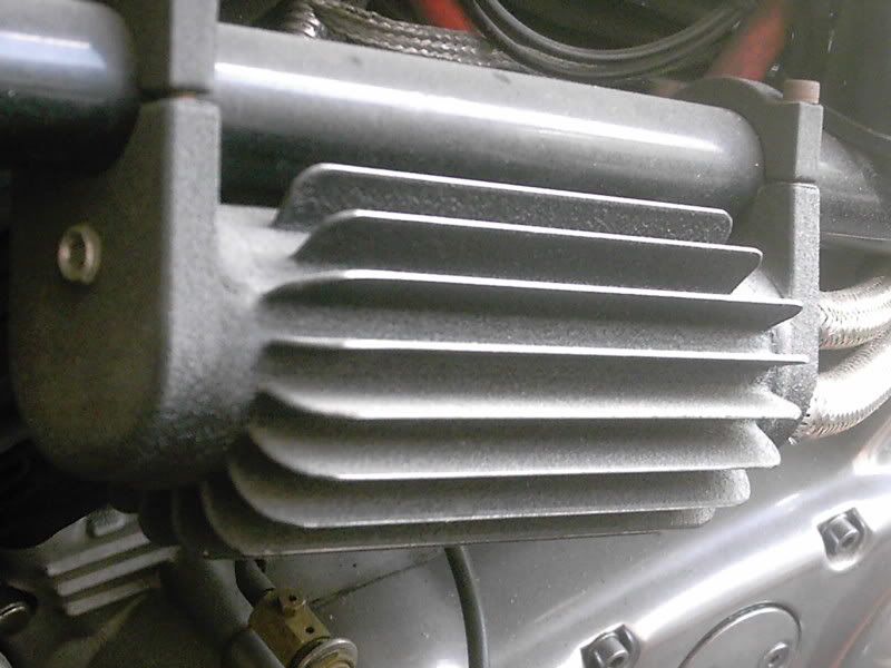

Dragstews, what and how do I get one like that? I also like the F-100 style one but I'd wanna hide that one i think under the bike. I was thinking of getting some heavy wall aluminum and turning some ribs into it on a lathe. Ribbed for my pleasure I guess.;)
They are made in Vegas .....
Robert Spurgin is the guy's name.
I traded out some work with him for the one you see on my Buell..
He can make them in any mount ....
http://www.jpcycles.com/product/740-948
That is awesome, really sick looking, as well as functional.

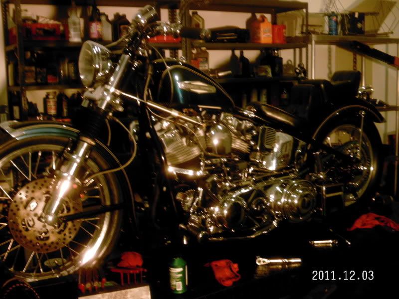

Use a Ford cooler on the 52....Cut it down to what I needed and welded it in..
In order to get some air to it...Cut in four louvers on the inner primary..
Mod. the stock oil tank to hold 6qts of oil also helped in keeping it cool...
Use a Ford cooler on the 52....Cut it down to what I needed and welded it in...

Really don't know who made it....
Got it from Sandy Kosman back in the day...
There is no ID on it....Has 16 adjustments for the damping...
I made up the mounts for nailing it on the 52..
Think it may be the same one that Steve Storz sells..
http://storzperf.com/jpgs/page16.html
