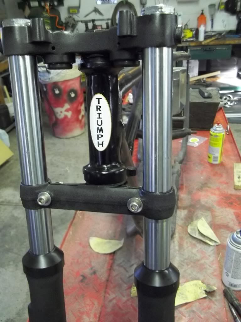

ok heres what I got so far..been a long fall finally getting a few things done on it..650 Triumph..not sure on the tank and bars yet as always it will change several time befor its done..thought i"d fill you cats in..hope to have it rollin by march/April?..sportie front end lowered 4"..maybe a sissy bar?..

tx man..yeah that was fun bike. I"m from Rockcastle co..but live here,,so stop in if yr in town..front end is off an 80"s sportie..lowered 4"...they fit fine but you gotta get a special bearing kit for the 1" stem..see low brow customs to order some//

Love them triumph's You might consider welding a couple brackets on the frame to mount your oil tank to and have it as far to the top of the frame as you can get it after you have your brackets welded, drill an tap them then bolt your oil tank to them. Just my 2 cts.
