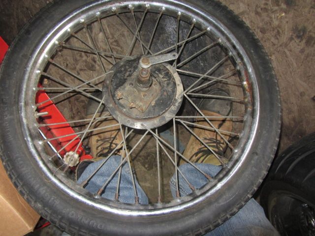

need help with a mystery wheel
1790 Views 12 Replies 10 Participants Last post by  panman
i got this wheel in a package deal with a vintage 70's springer front end i bought. what you will notice that it has a very unique hub. unfortunatly i didnt get an axle with this wheel. i am looking to everyone here to find out something about this wheel. i work in the motorcycle field and have tapped my resources with all the gurus that i know and no one has even seen such a thing let alone know anything about it. if thats not enough in the middle of the hub is a spring but both sides of the hex move in unison. thanks to any input anyone has.

The spacer that goes inbetween is octagon on the outside and a round hole in the middle for the axle. The bronze bushings in the middle are the brake shoes which are tapered. You are missing the brake actuating arms that when the cable is pulled pushes the bronze cones into the hub. It's pain in the ass to set up. Mine still isn't right
wow never guessed its a brake. very interesting thanks for sharing that. any idea who made these or when? im sure the chances of finding the rest of the pieces are slim i guess it will have to be a conversation piece.

Rather than open a new thread I thought I would post my question here..Anyone know what this is off of? Oh yeah, it also says MADE IN ENG on it.
Thanks
Mike
Nice Ink!!! BSA Bantom?
Thanks on the ink. The word there appears to be JONES.
