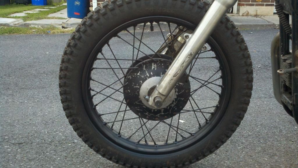

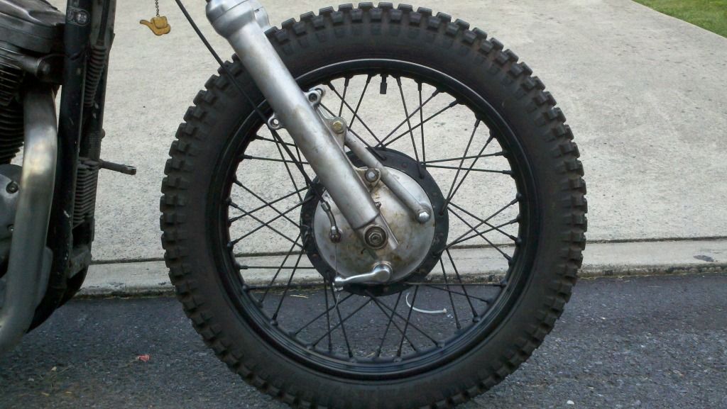

The rim is a 19" stamped with "JONES" & "MADE IN ENGLAND". I bought a pallet of mid 60's British wheels at an auction a while back, most of which I sold on here for 1/3 the price eBay would fetch so I'm just asking for a little help on this one so I can order some brake pads before gypsy run... any help would be appreciated. Thanks!

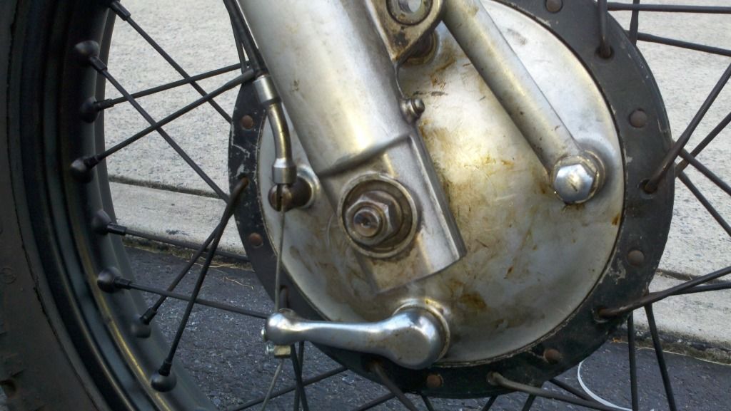

is that a clutch cable or is that actually correct
It's a brake cable with a cable guide from a clutch cable I had laying around. Seemed to fit nice.
def not ajs or matchless or triumph
ariel would be my best guess
Thanks man! I've looked up Ariel drums before but didn't see any like mine, this time I dug a little deeper because it was suggested here and another forum.
Guess it's from a 1958 Ariel Square Four from what I can tell.

Yup, it's late Ariel. It's too pretty to be from one of the big manufacturers. It looks like a late 50's Square Four brake to me. Maybe a from a Huntmaster as well.

We must have posted the same time here. I agree, it is kinda pretty. If my bike was a little shinier, this probably have polished up pretty nice.

You ought to match the angle of your cable and brake cam lever to the Square 4 pic, it'll work better. Also, is that a solderless cable end? Better get a soldered end to avoid the risk of that little bolt slipping on the inner cable when you really need it.

Looks to me like a 1955 Ariel red hunter front wheel. could be wrong but looks just like what came on my bike.
