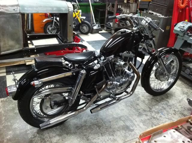

I've been wanting to build some sort of scoot for years, but always had a Hot Rod or Custom I was working on.... still do, but it was time. Wasn't sure which way I was headed with it, first I thought I'd go the British route, maybe Triumph or a BSA. I looked at a few projects and runners, but they just weren't doing it for me. I finally decided on a mid 70's Ironhead Sportster. Again, I looked at a lot of projects, and came close to the purchase of a runner or two, but if it wasnt one thing it was the other. Between bikes that were misrepresented, to ones with registration problems, I was lucky enough to find one that was very nice, complete, and for a great price too! I'm real weak on computer skills but think I may have figured out how to post pics, so I'll try. First will be a before and after (now) shot. I took some pics along the way, I really should have taken more, but I just get carried away working sometimes.

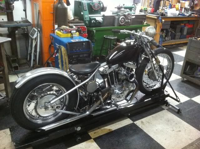

Wow thats a well equipped workshop you got right there" BC Hey where all the snow

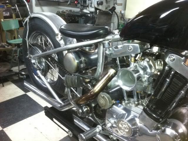

Here are a few more. I replaced the flat ends on the oil bucket with domed ones, and built rear fender struts .
That looks real nice! Clean and attitude all at once. Hope to see some build pics later.

Thanks, its taken a long time to get the shop to where it is, I'm very fortunate. As for the snow...we got hit the other day 4 or 5 inches or so, not too much.
Nice work !!! Are the tail and springer after market or did you build them ?
Oh yeah,and did you do a complete tear down to hardtail ?
That is one sweet looking Sportster !! Now, we just need the details, etc. etc. :cool:
Yep, tore it down to the bare frame, I'll post some pics of that soon. The hardtail is a Santee that was a Bolt/weld-on style that I modified to full weld-on unit. The forks are 4" under DNA.

Looks good so far. Is that an A roadster in the back?

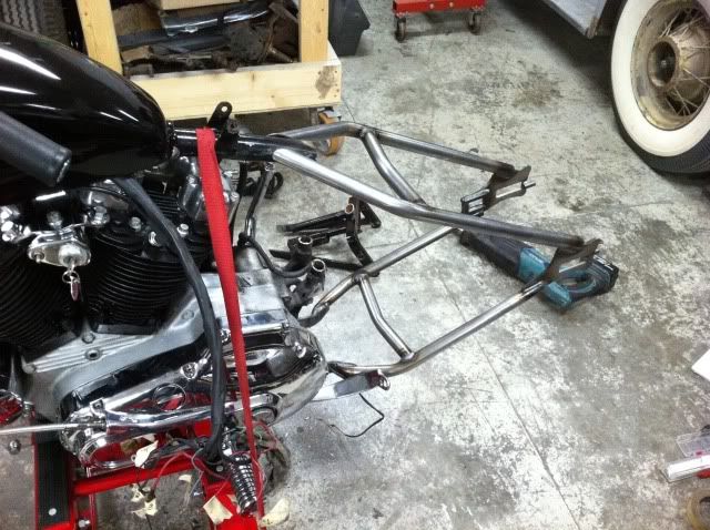

Here are a couple of the hardtail being modified to full welded on. I initially bolted it on to the lower end and then welded the upper tubes to the backbone. I even went as far as to weld the lower bolted ends in place. Not liking the look of it all, I made up a makeshift tubing support system to hold everything in place (believe it or not it worked fine). I proceeded to cut one lower mount out at a time, then weld in a piece of 1" I.D. DOM tubing to the frame forging. From there I bent up some 1/8th wall 1" tubing to replace the lower leg of the hardtail that I had removed, slip them in place and weld it up.

Deuce.
