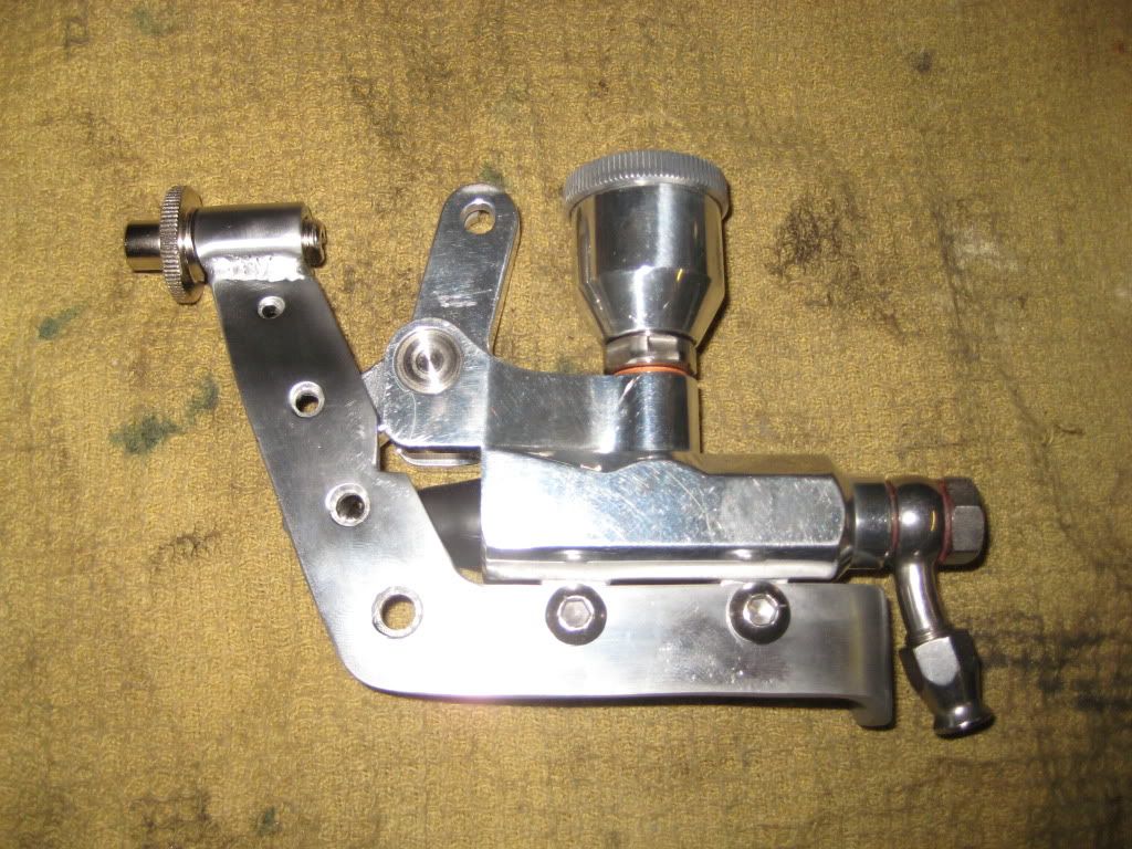

NOW... has anyone used a remote master cylinder set up with good results???
Im looking @ the one from Fab Kevin....mounted somewhere on the frt legs inconspicuously...cable actuated...
any thoughts??or examples???

Suzuki gs/gsxr mc are small and cheap on the ebay. . They look like the fab Kevin ones without the mount and mechanism. I retapped the banjo threads to standard and used a banjo bolt with a switch for brake lights. Cost me about $40 for everything.

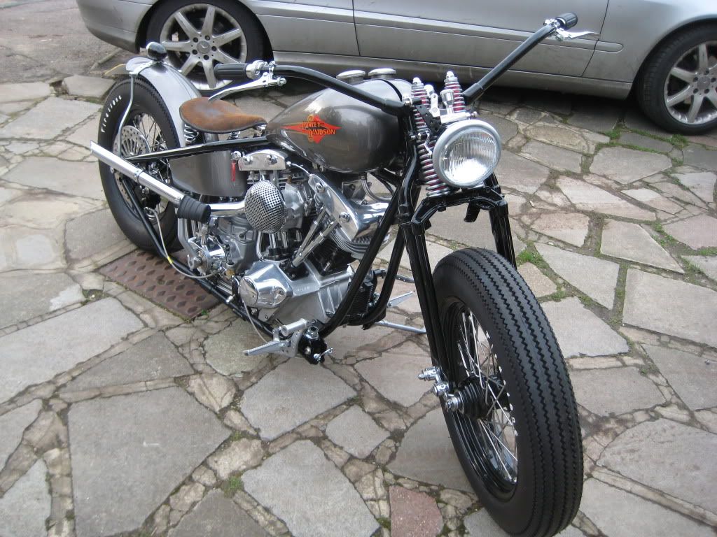

Got this MC from Custom tech & made up the mounting bracket to fit behind / over the front light
