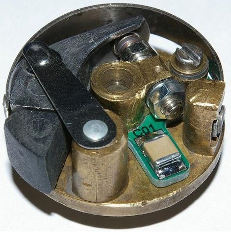

I don't do much endorsing of products, BUT this one has my full attention. To all you guys with Lucas magnetos with problems, get ready to see it fully functional for about $23 shipped, along with a little work in your garage.
If your bike runs poorly, backfires at all but idle, stalls out and won't start back when hot, then works again when cool. Your mag likely has a bad condensor. The condensor is in one of the end caps of the armature and is not very serviceable to the average Joe. If you're thinking of buying a generic automotive condensor at Auto Zone, don't. I have tried it. It works on the test bench, but not on the road. Not at all.
I saw this product while digging around on the interwebs, and had a crap mag with the above symptoms, and thought "What the heck, It's only $23, I'll try that". The guy I got it from (on e-bay) joined the jj and made one self-promoting post (up to now), and that's it. His user name is "skipsoldbikes". The little chip showed up today, and I got it installed tonight by the directions on the MFG's website: http://www.brightsparkmagnetos.com/ which does detail how to disconnect the original Lucas condensor (less than an hour of work).
I am here to tell you, this 50+ year old mag is performing like new, or at least freshly built. I did disassemble the whole thing, clean all tracks and brushes as well as cleaning and greasing the bearings. I will keep you guys posted here on this thread, on how long it works, as time goes on.
Here is a pic of the item that did the trick. Also know that I paid for this thing, it was not a gift or "demo" or anything of the sort. The cool part about this arrangement is, you can change out this condensor, if it fails, without disturbing the timing of the mag. I have not spoken or messaged the above mentioned member as of this writing, but I do hope he chimes in with any other relative info that may help other jj'ers keep their Brit machines in the breeze. He sells 7 different ready to go models plus a DIY board. This thing got my '55 back on the road for $23, instead of a $400 rebuild, and a three+ week wait. I hope this info helps.
Cheers, Dan.

I recently installed one of these on a BT-H mag from the 50's. It was dead as a door, no spark at all. After putting the brightspark cap in, it produces a healthy spark when turned by hand, and on a test fixture ran for 5 min @ 2000 rpm without a single miss.
These are only user friendly if you have access to the condenser leads, if not you have to pull the slip ring which is very fragile, and if you are a gorilla with tools do not attempt it. Anyway I second how cool this product is.
^^^ Agreed!
On a K2F mag you can get to the condensor leads without pulling the slip ring. I have no idea how hard it is to get to the leads on other mags. On their website they have a step-by-step pictorial on how to perform the "condensor-ectomy" of the offending Lucas bit for the K2F series of mags.

I contacted Skip Brolund [email protected] as he is a vender for the Brightspark products. Skip is in Ohio and that's pretty close to where I live in Michigan. Skip was a very large help with parts and needed info. he runs a magneto repair shop that does more Lucas magnetos than most other brands. yet just the same, he has worked on every brand of mag known to any engine that burns gasoline. Skip sent me a C02 condenser as it looked to be what I thought would fit the easiest in this Robert Bosch ZEV magneto. with very minor fitting issues the C02 chip fit, minor file work on the chip mounting board and a slight die grinder shave on the points carrier it fit.
this mag made spark before and the engine did run on the test stand. the starter on the stand turns an engine pretty easy so it did fire and run. kick starting was a different story. I would dare say we kicked the engine over enough to warm it up and brake the rings in before it ever started. after rebuilding the mag with another nos condenser, coil and a magnet recharge, it didn't change things much. spin it fast enough and it would spark, kick starting was just not happening.
I'm very pleased to say with the BrightSpark chip condenser the mag will produce a hot spark with a half turn of the armature. with the mag installed the bike fired up and runs as it should (video when I get a chance)
the BrightSpark chip flat out works.
if your in the Ohio area (or not...) Skip is a supplier and also a full service magneto shop for Lucas and other brands.
you will not be sorry with the BrightSpark product or Skips services.

Yes, the original condensers are buried inside the armature & require special tools to remove & reassemble. The Easycap mounts on the points plate for easy access.
The Easycap is a ceramic condenser, less susceptible to heat issues than the original.
