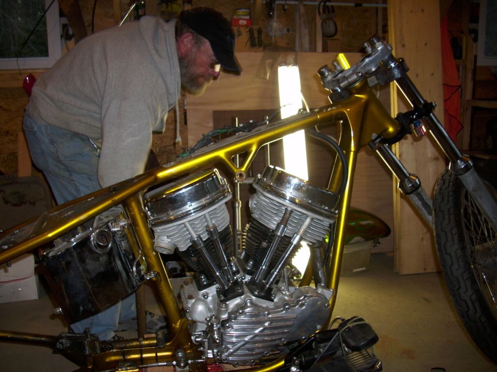

Well here we go. Started my last known build. My first build was 40 yrs ago this winter. I am 60 and ride a kick start only shovel. This is a rigid kick only pan. After my first bike I have never rode one I didn't build. That has been 2 Sporty,s 8 pans and 4 shovels. The build is a rigid frame 53 pan fresh top to bottom and redone tranny. A narrowglide and disk brakes. Started tonite after chow with my best friend Brad his first build lol (He buys ready made bikes) Hope fully I will get better at this thread thing as we get gtoing thanksw for looking .

You young wippersnappers think you have done it all. hahaha. Yeah, you have many more years of building on your lift, so just get this one done, and start collecting parts for the next one. If you are like the rest on here, you will, and you will be smiling the whole time. Looks to be a sweet project. If you have them, post photos of the previous rides.

Lookin good so far. At only 60 it's the new 40 ya know prolly not your last build!:)

was looking for another picx and found these thought that I would add them.The barrels rebore to 40 over with keith black pistons. The heads are compleatly redone Manely shovel valves and guides. Eastern steel seats. NOS rocker blocks and shafts ( paid way too much for them. all new springs , keepers and seals. And have quit smokeing lol
