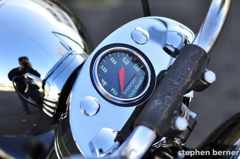

Always did like the looks of the K-Model Speedo...
May have been a little optimistic on the top Speed at 120 mph, Just a bit...
Could be a thought...???
