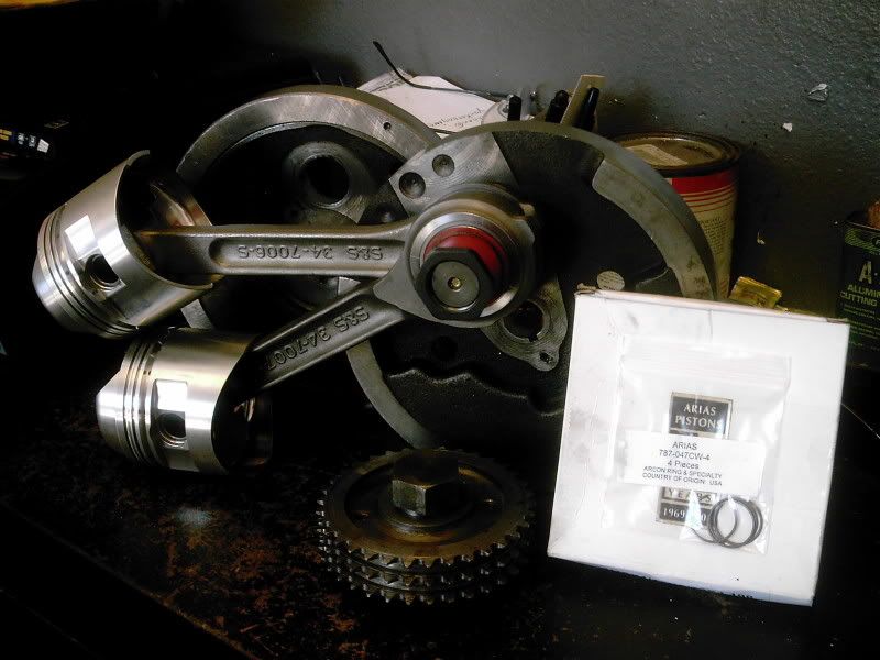

One Box from USPS showed up today....
S&S has did a little update to their rods....In a effort to get much closer to matching the reciprocating weights they added beef to the front rod....
Nice..:)...Less work for me to do to get there...;)
Very lovely .010 pistons (Arias) from Jim's...Tis a dang shame that they can't be seen....:(... Although I would say that they sure will be felt...:D...
Not all that Happy about seeing Hammer marks on the flywheels in the Pin (No Hit) Zone....
May be a problem with truing if the tapers are in bad shape...:confused:

Btw the hammer hits were from a PO .. Not my hamfisted hands
