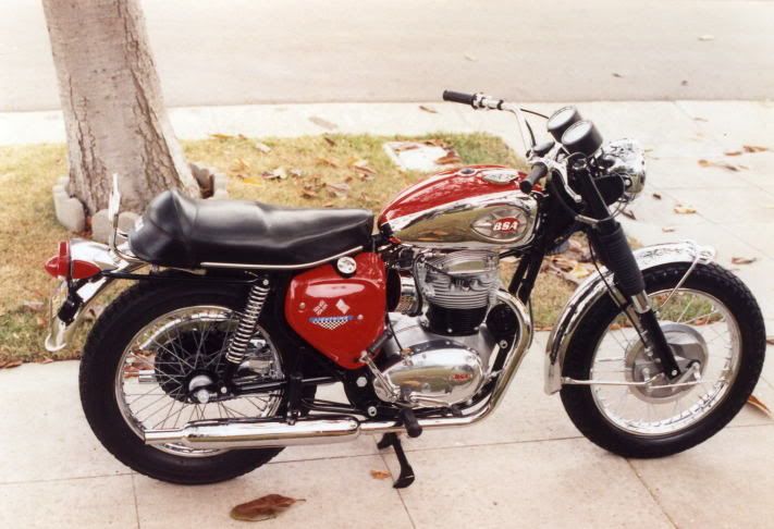

Looks like a '69. This is Siggy and his '69 Lightning. Where are you Sig ? Still in Germany?
