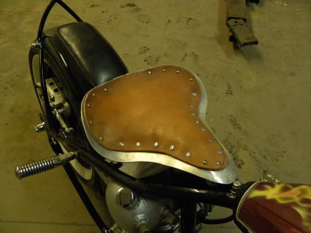

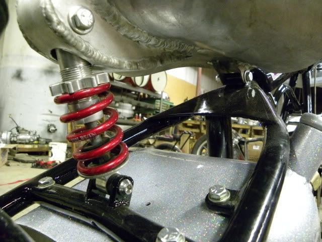

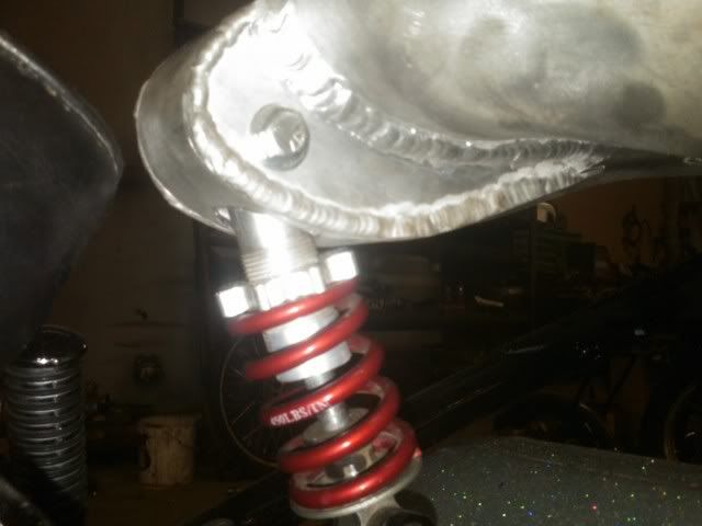

I was asked to show a better detailed shot of the mounts and profile. Here they are.
Is the hammer bag homemade? If not, where did you get it from and what are the dimensions?

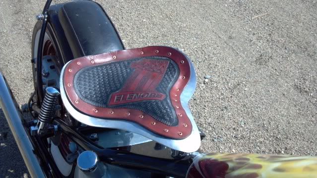

I had a friend of mine tool the leather with the bike's name in it. He did an awesome job!! Check out his work http://bigjohnsshop.blogspot.com/
One of a kind seat for my hand built bike. Kindof the icing on the cake.
Just a few minor details to work over, but she is ready for summer!
