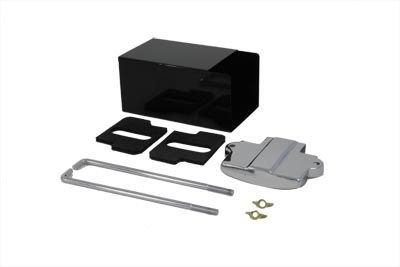

This is a grand idea and is well made...
Will allow a Mini AGM 12 V bat to fit the OG Horse shoe oil tank and appear stock...
Has room for a few Hershey candy bars at the bottom of the box..too.
