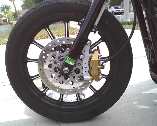

I really like the Tokico kit that FK is offering but it won't fit on a narrow glide front end.
Fab Kevin doesn't list it on his site, but he has a Tokico caliper setup that'll work on a narrow glide. It's a Tokico 2 piston caliper - 2 pistons on the outside, and a stationary pad on the inside, similar to a Harley single piston setup.
He has them for 10" and 11 1/2" rotors, and my Part-timer Steve has been running this setup for over 2 years on his 39mm narrow glide with a 10" rotor, and a 21" wheel, and here's Kevin's Industrial Desease with a 19" wheel, so you know they'll clear......call him.
