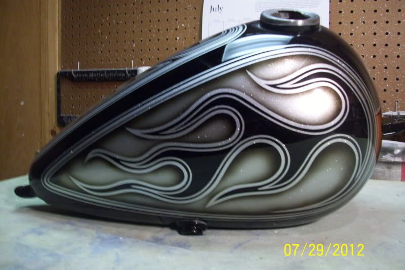

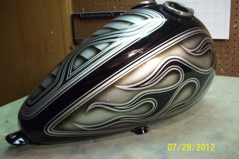

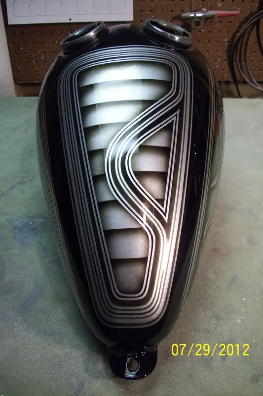

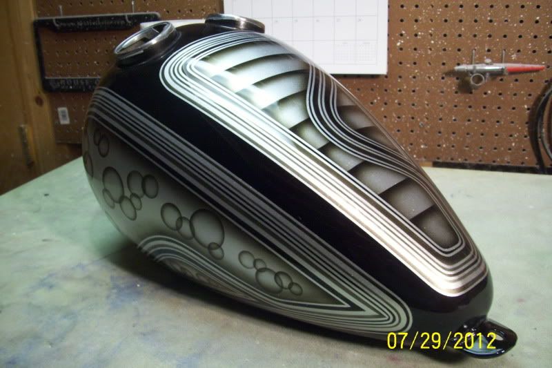

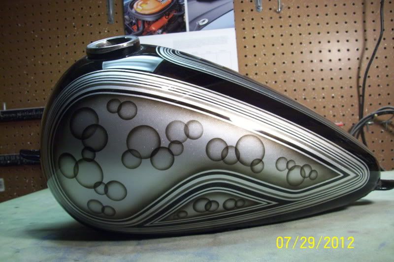

Good lookin' paint and shirt. How about something to sit on? Made this for a cat in the pacific northwest.
