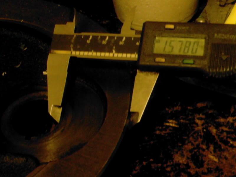

So I have this "found under a tree, in a barn, dropped by a stork." cone shovel. As I roll the bottom end through I head a scrap and felt a sharpness on the flywheels on the pressed side. So I split cases... I can't find anything in there (as the boys are good at tossing pennys)). I know there is a way to measure from the crank pin to the wheel edge to see what wheels are in it... I know that 1.7 (ish) is a 74... what the hell is 2.275???

Somewhere I have those specks for both the OEM wheels for 74" and 80"
in the STD 8-1/2" O.D. wheels.
But do suffer from CRS at times....
Put in a call to TJ or Paul at..... http://www.truettandosborn.com/flywheels.htm
They can tell ya what it is...
Played with it a lil more.. one wheel is spun but still.. these are not 74 wheels... hell if i played stroker at this age..... well..I wont die but, I'll still blow it up.
my 74's run 80 all day long some 20 hours... I'll stay with stock.
thanks dragstews!!! I knew you had it somewhere.
Butché
This wheel is an 80"
Has the OEM casting # 23-94578
But this was some of Harley's years of let's screw around with the techs some..
You call T&O with this figure and it may very well turn out to be a 74" in sheep clothing...
