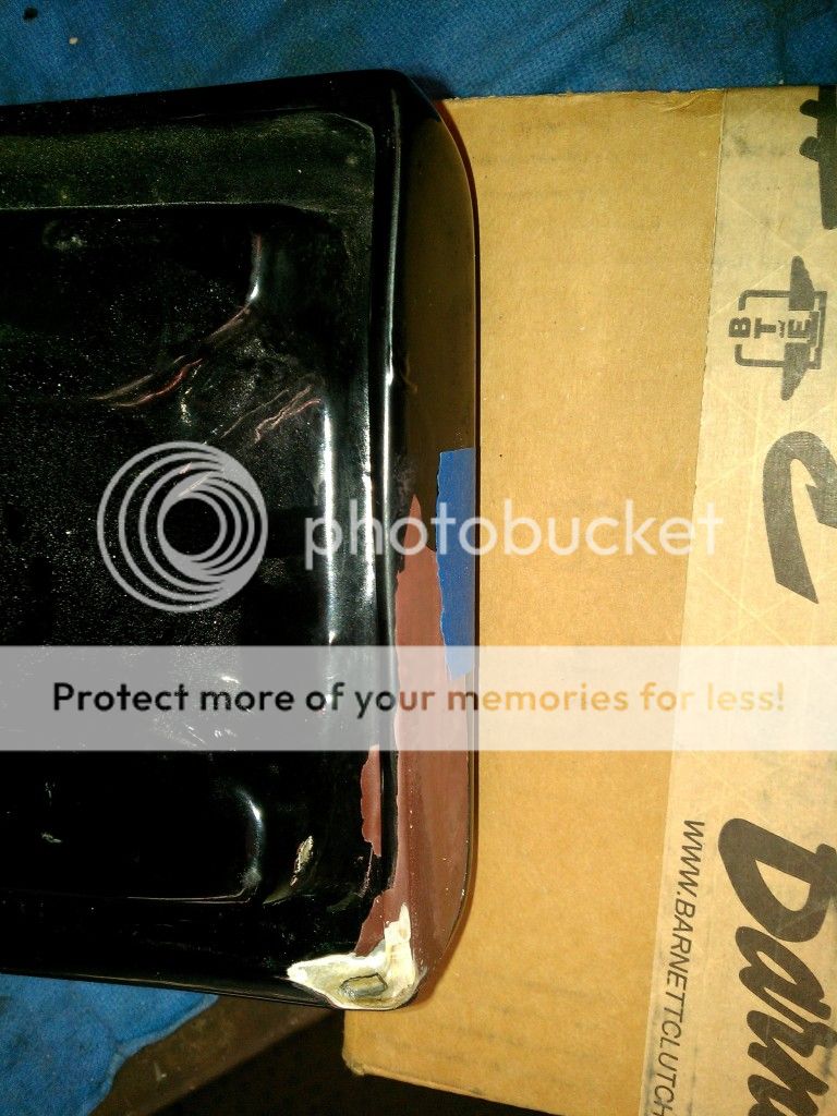

I unfortunately discovered a leak in my XR style fiberglass gas tank.
I dont have much experience w/ fiberglass, so what are my options?
Whats the easiest way to repair?
Just resin?, Resin and cloth?, Resin and mat fibers?
Completely different technique?
Whats recommended to rough up and prepare surface?
The leak is seeping from a seam on the bottom rear edge, circled in pencil.

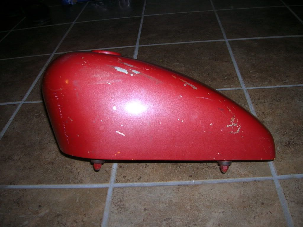

Im going with a lot of fiberglass on my De-Raked Generator Shovel project.
Ive got this fiberglass tank I'm running along with a fiberglass rear fender.

Thanks for the offer, its appreciated.
I already did the fiberglass resin / mat repair.

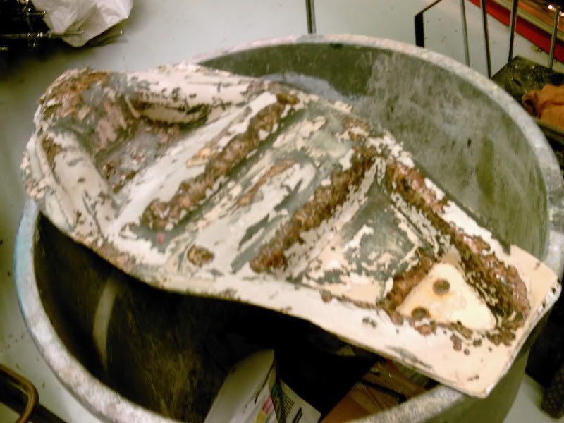

What you see here is the Kreen sealer or what's left of it....
Short time cure for a leak....It became hard as a three day old brisket....And stated to flake off...
What looks like oatmeal is the glass with the risin ate away.
Cut the tank open for sanding down and a new layer of glass....
Then a coating over that ....Still was a poor repair.....
......................Leaked Again.......................
Choices was a bladder to be installed...that takes up gas capacity. With only about 3 gallons to start off with...Didn't care much for that idea..But kinda still kicking around the idea some....
