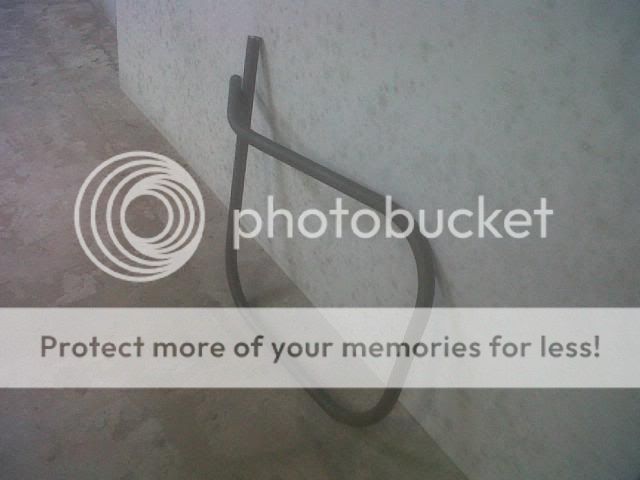

really like the featherbed frames so that's the basic start of this long road.. got lucky to have a guy loan me an atlas thinline frame for a week to let me measure and make form jigs and yesterday after a day of scrap i got one side bent up!....so here's the start of a long road...
...any suggestions along the way chime in!

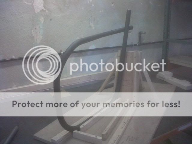

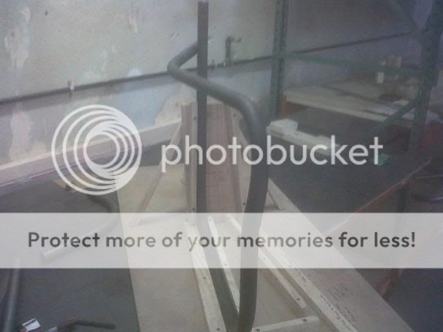

well the metal is flyin today! got the other side of the thinline done and figured i would bend up some 4130 for a wideline..can't do that rear kink in the 4130 so wideline it is for that material..here are the pics

don't know what motor yet..i have none yet..thinline is 1.25 x .120 wall DOM wideline is 4130
