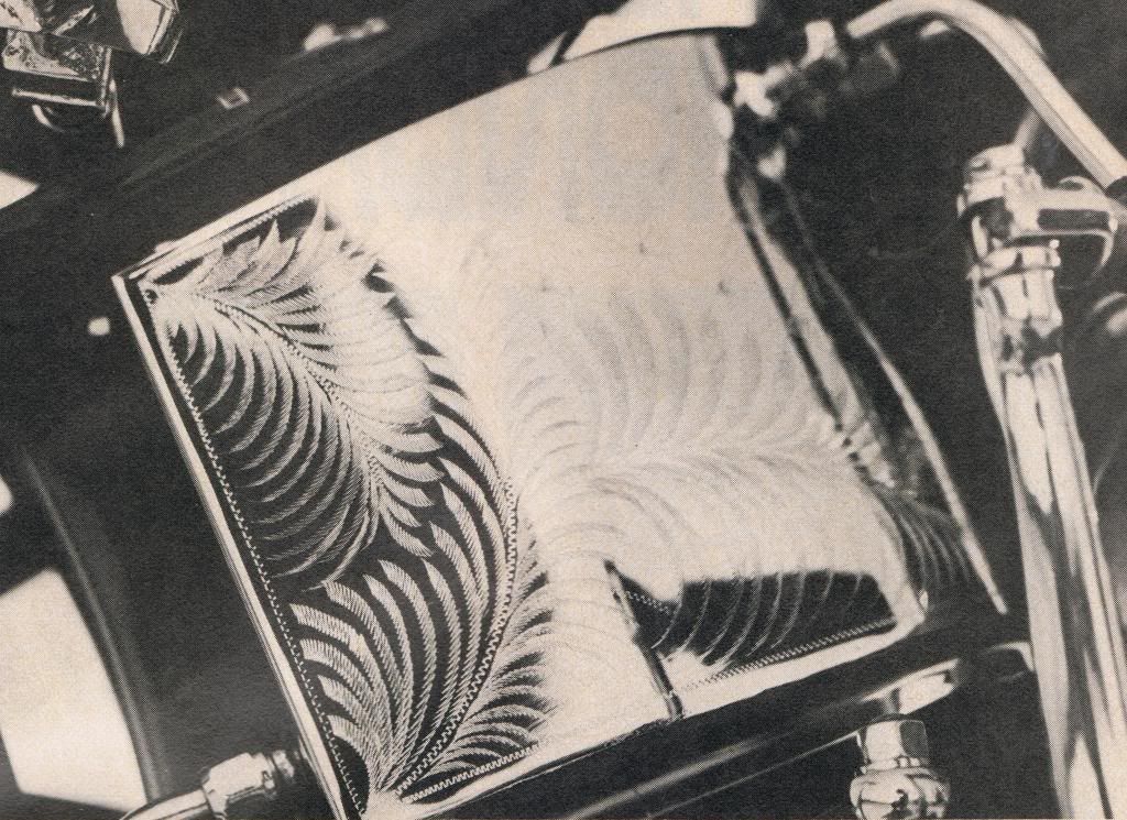

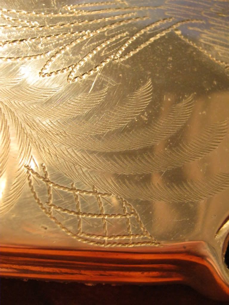

Recently got an engraved cover, & wondering if this style of engraving was a common thing.. can't find any info on the net & thought perhaps a member here could shed light on the subject. Both pics are of stuff engraved in the late 60's / early 70's. I'd like to get the rocker covers done to match.
2,083 Posts
Wiggle engraving. Common on brass instruments. Also a feature element on Western style gear. There's a vid somewhere on Facetube of a Japanese guy going at a sax with a monster graver that looks like a sharpened bastard file.
18 Posts
Rocker engraving was done in the 18th century on trade silver, trade to the Indians for furs, lots of animal designs, rococo, British Coat of Arms, etc..not a new technique.
Other stuff is in relief and chiseled, this is done by drawing the design, and chiseling everything around it away, then carving into the design for highlights and detail...
